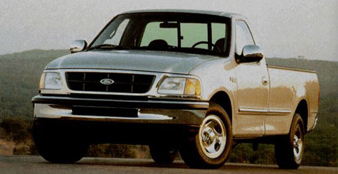

Sorry about the confusion. 1997-98 4x2 models do not have fog lights and have a large front bumper. The 1997-98 4x4 have a similar large bumper but with cutouts in the metal that are covered with a plastic insert when they are delivered without fog lights.
Here is a pic of a 97-8 4x2
Here is a 97-8 4x4
You would have to purchase a new 4x4 bumper to be able to install fog lights.

I hope this clears up any confusion.
Regards
Jean Marc Chartier
