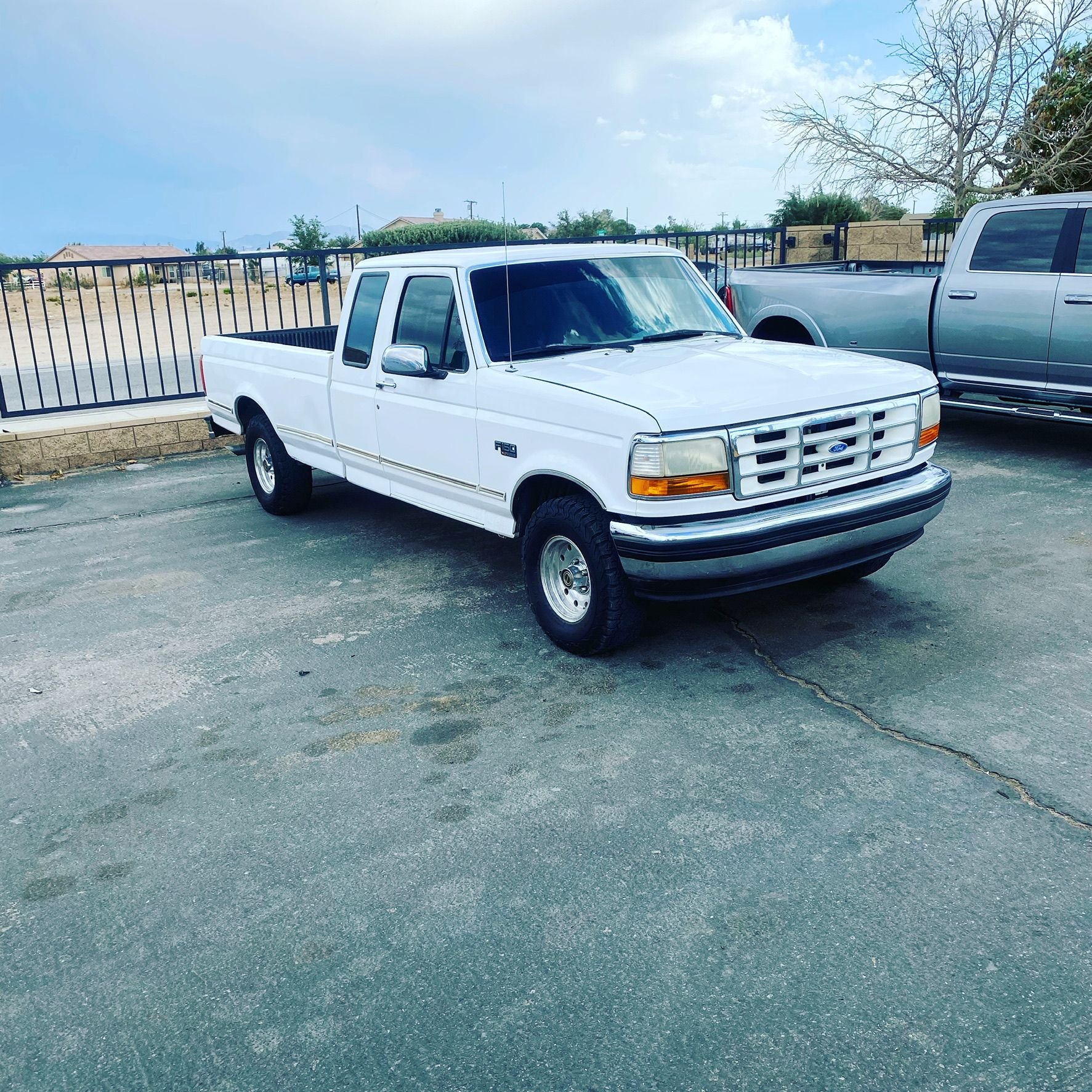

I have a 1995 2wd f-150 with the 5 liter and the 4r70w. I’m pretty mechanically inclined and understand how a transmission works but have zero experience on working on them. My truck has a severe hardshift from first to second like I’m getting hit by a semi. Also the truck seems to not really know what it wants to do gear selection wise. When traveling at a quarter throttle the truck will up shift into a higher gear and bog the truck out below 1500 rpm’s I have to give it more throttle to get the truck to down shift back into the gear it was in and apply power. Also a couple times the truck has gotten stuck in between 3rd and overdrive causing the truck to free spool. I have to slow towards 45mph for the trans to decide what it wants to do and shift into a gear. I have replaced the throttle position sensor, and both vss. Although after changing the vss in the rear end my speedometer now waves over 65. I just can’t seem to figure this out it doesn’t seem like the trans it self is bad it just seems like what ever is controlling it is having issues. Anybody on here have any experience in a 4r70w doing stuff like this? Any help will be greatly appreciated I just don’t want to for the 3,000 over for a trans rebuild. Thanks a ton guys!
