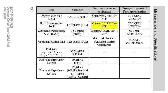

Old May 8, 2009 | 10:10 PM
Originally Posted by Fifty150
I have used Royal Purple, Lucas Oil, Red Line, Motorcraft, and Mobil 1. All worked just fine for me. Just remember that your 2007 calls for Mercon V, not Mercon III. Make sure that you get the right spec. Fluids are not all the same. My last batch of fluid came from Red Line, and only the Red Line D4 & High Temperature ATF meet Mercon V specs. All other Red Line brand ATF does not. So just be sure to read the label carefully.
It does not say to use Mercon V!
