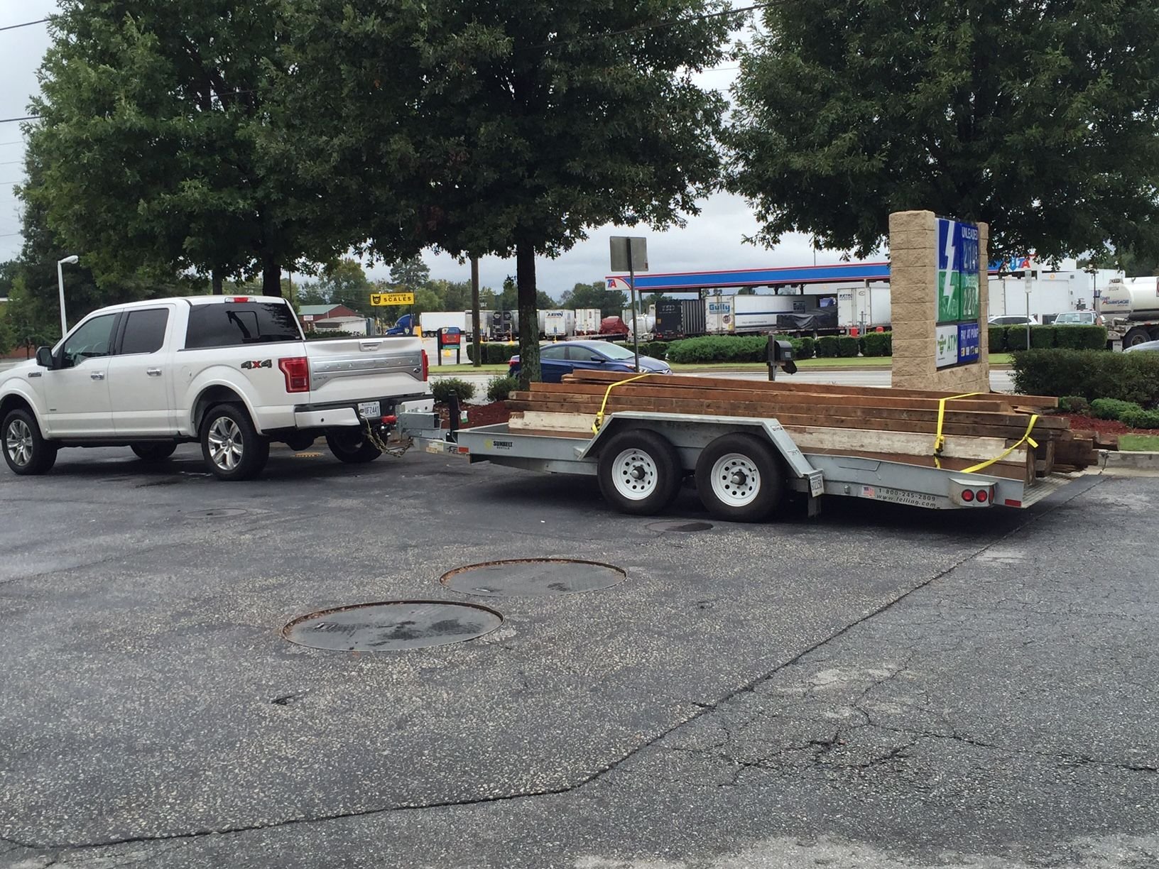

Towed a 16' trailer yesterday with wood beams. Beams were not evenly distributed (first mistake).
Truck wandered above 45mph - had to use back roads. Truck is '15 with max tow package. Also, trailer brake said 'no trailer'.
Notice large beams not evenly distributed
Majority of weight behind wheels of trailer

Yep, looks like not enough tongue weight for sure.. Get more tongue weight and it'll tow much better.
As for the brakes, it looks like the trailer has 'surge' brakes, so the trucks electric brake controller had nothing to 'control'.. Was it just a flat 4 plug for the trailer? Or the round 7 pin?

Reason why truck wandered was because you took weight off the back end. Should have got a hammer and smacked boards closer to front. Valuable lesson learned from that.

I agree about the tongue weight. It needs to be between 10-15% of the trailer weight to prevent trailer sway. Your load looks like the tongue weight was almost zero. The load you were carrying makes it difficult to get the proper tongue weight though, because the boards would have had to extend beyond the front of the trailer.
You MAY have overloaded your hitch too, if you were using only a simple drawbar in the receiver. Those are normally limited to 500# towing weight. I think you need to use a Weight Distributing Hitch (WDH) with that load.
If the truck did not "see" the trailer, then, if you have electric brakes back there, they weren't connected.
