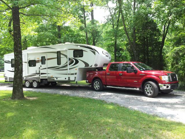

Pulling mine all over the country...

What are your axle weights when on vacation? I weigh over 250 and took a F150 screw with a 27ft 5th over the scales last year trailer was empty and nothing I could see but me in the truck and only had 50lbs left on rear axle rating. The advertised towing limits don't include weight of driver and cargo or even a full gas tank. I am sure you pull it just fine but have you scaled it?

Have not scaled it yet.

I would love to see the real world numbers on a CAT scale. I know the motor will pull it so I don't doubt you drive just fine. I pulled a 36ft travel trailer with my 98 F150 w a 4.6 and it towed it pretty decent even though I know for a fact I was several thousand pounds over weight. My equipment trailer with my tools gear and bike in it weighed nearly 15k and the same truck pulled it from Louisville to Houston in 2000. My F250 Diesel I came back with however towed that trailer like a rag doll and I also know it was overloaded. Next time you hook it up and tow I would love to see how it scales Please. The reason I ask is the only time I ever get follow up info is when customers have a problem.
