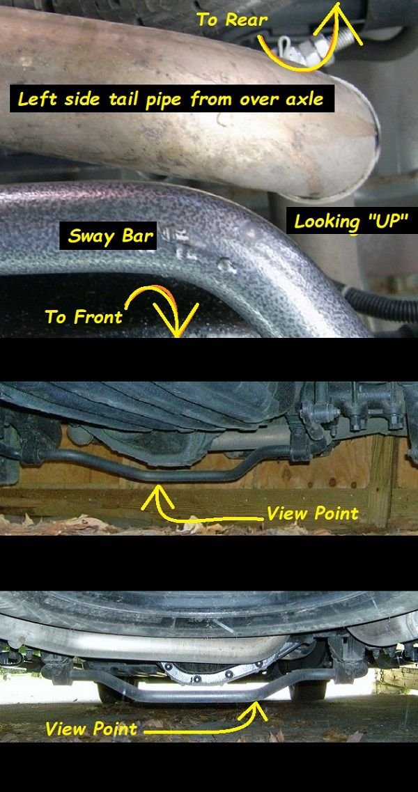

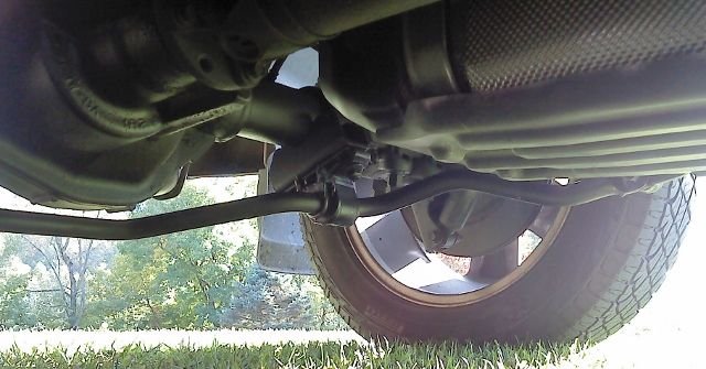

I did some detailing and adjustments under my truck. I still have the Hellwig 7705 rear sway bar "upside down", it works. I readjusted the end links to work on the rear most or stiffest position of the 3 holes. There is a "kicked out" section in the "lazy-S" of the sway bar's arm intended to clear the OEM muffler, but my muffler is smaller, that's not needed there but it works really well on the gas tank side to keep distance between the tank & sway bar. The sway bar doesn't care, it's always being twisted anyway.
"Right side up" or "up side down", the effective arm is a line through the pivot under the axle and the mount bolt for the end link. I fine tuned my side to side adjustment too. From center line of sway bar U-bolt to the nearest axle U-bolt center line on the right rear or muffler side is 7 inches ... and it's 6 inches on the left rear or gas tank side. My sway bar is thus 1/2" off center, but it works. At it's lowest point behind the differential it's7.5"off the roadway, a little more than low points in front of the truck like trans crossmember, etc. My sway bar mounts are also tilted towards the front of the truck 20 degrees, this lets the kick out designed to clear the differential cover go up on bumps (as the links go down with truck) and maybe just "kiss" the tail pipe crossing over for the left exit. Even then, it would require near bottoming the truck. My two links to the frame are 11-1/4" center to center of bushings and I measured that "extension" that I made to bolt onto the right side next to the skinny muffler. It does not "extend" the arm, it just duplicates that "kick out" that is now on the left, it has my links near straight up & down too.
Also, over on the right side, I had built and installed a 1-7/8" "extension" (originally 2-1/4", I've cut it back since) that mimics the bar's "kick out" that is now on the left, it could be less but with my bar centering as it is, 1/2" off center to the left, it works near perfect. The extension is also bolted with a second 1/2-20 grade 8 bolt to the sway bar to aid support for the link attachment. You can see it on the far side.
I can tell it's stiffer back there (than middle hole) when crossing bumps at other than straight on. Very pleased I am with the "feel in curvy back road driving" too. As always, I cleaned and painted some.
I think my camera had a tilt. If one draws a straight line through the under axle pivot mounts forward through the lower link bolts, it's the effective arm and very near level, just slightly upwards.. I also had already reinforced the upper mounts for the links at the frame.
I saw my other photos went away. This below might illustrate my clearance issue with the exhaust pipe. If not for the SS aftermarket SI/DO set up, would not be an issue.

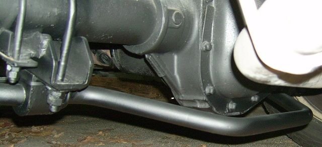

Yesterday (10-01-20), I backed the truck up on ramps again and I removed the 5/8" spacers I had made and placed under the sway bar pivot bushings last year. There is 7" of sway bar behind the pivot centers in that differential clearing kick out. There are the three adjustment holes at 17, 16, & 15" ahead of the pivots at the link end. At the stiffest hole, 22" from link end through pivots to rear of bar behind the pivots. Removing the 5/8" spacers 22/15=1.47x.625=0.92"or very near 1 inch change up at the rear most point. I then shortened the two links by eliminating all adjustment by screwing the threads all the way in and locking it there, that raised the front link end of the sway bar 1" (as I had the links adjusted 1" of threads showing before) Shortening links 1" is like 7/15=0.47x1 or 0.47" drop at the extreme rear of the bar behind the differential. 0.92" up less the 0.47" down = 0.45" net up change at the extreme rear. I measured clearance under the extreme rear of the bar, it's now right at 8" where it was 7.5" a couple days ago. It's now higher than some points at the front of the truck and only about 3/4" lower than the differential bottom.
If the U-bolts and saddles that mount the sway bar under that rear axle look odd, it's because I married some 3/8" (bolt size) type HD exhaust type U-bolts beside them to hold in place if I removed the sway bar for servicing the rear differential, but I don't think that will be needed. Not a lot of welding, I used U-bolts that fit the axle tubes. Look to far left of below picture.
I like this better. I still have room for the bar to move upwards without hitting that pipe.
10-08-2020: I checked the angles of the mount u-bolts and added 5 degrees toward the front, (measured @ 15 degrees with truck backed up on my shorter 6" high DIY ramps, I increased it by the 5 degrees stated ... to 20 degrees. I think I first used 20 degrees, but that day it was backed up on higher Rino Ramps. I thought about it after finding only 15 degrees with these short DIY ramps) AND I put the 5/8" spacers BACK in place, thus shifting the bar forwards a hair more to miss the pipe. Painted again, will look for scrapes later. So total angle measured is 20 degrees forward with rear tires on 6" high ramps.
10-12-2020: Reset links length to show 20 threads, check links to each other using some 7/16" bolts, identical, so I welded 3/16" x 1" steel back strap to fix the length of ...and stiffen ... the links. Measured clearance, is back at 8" behind differential and misses the left side tail pipe now.
I measure the differential housing right at 9" off the ground at it's lowest, and now the sway bar is 8" off the ground at the lowest. From the rear, you no longer see the air gap between the sway bar and axle at center like in the picture starting this post.
