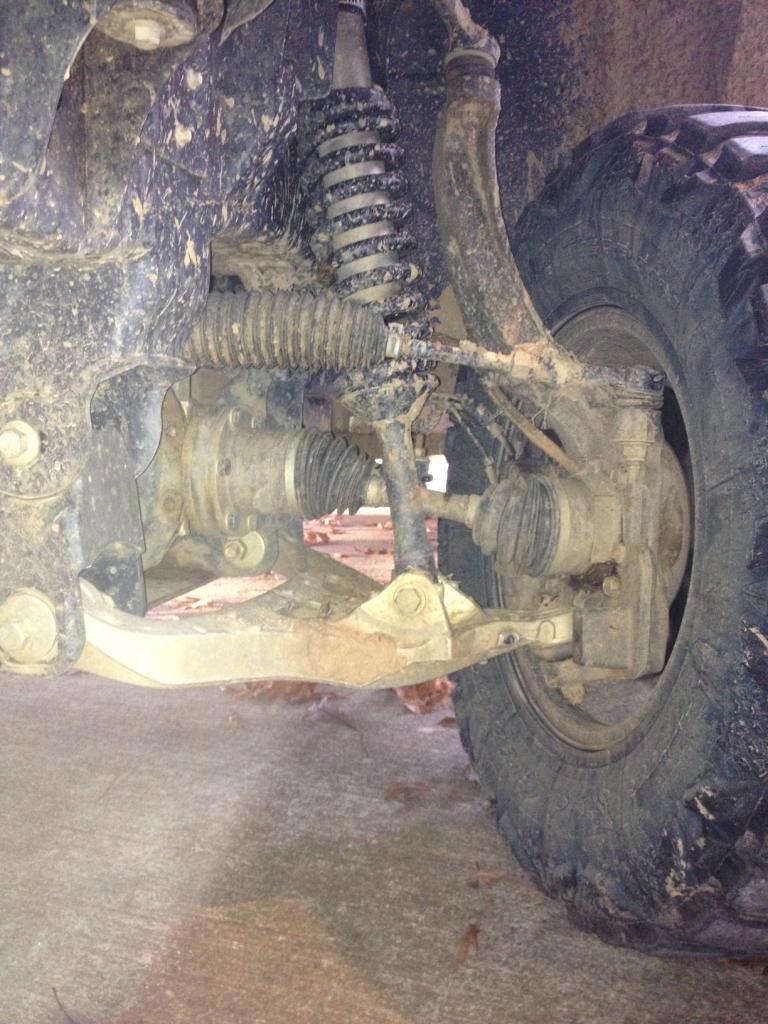

Mossy, post up a photo of your coil overs showing as much of one of them as you can.
I'd just go autospring 2" assuming you are at exactly 6" currently. Post a pic of your CV's as well with reference to the ground
Here's the cv axle
and here's the coil. The threads stop where my finger is

You're at more than 6" of lift according to your CV. Take some fender measurements and hopefully someone here will chime in doing the same.
IIRC at 6" it's around 44-45" at the highest point of the fender well from the ground. Might be more accurate to take a measurement from the center of the wheel to the highest at the wheel well to take away the difference from different tires or air pressure
I'd probably stick with like a 1" leveling kit if you can find one.
