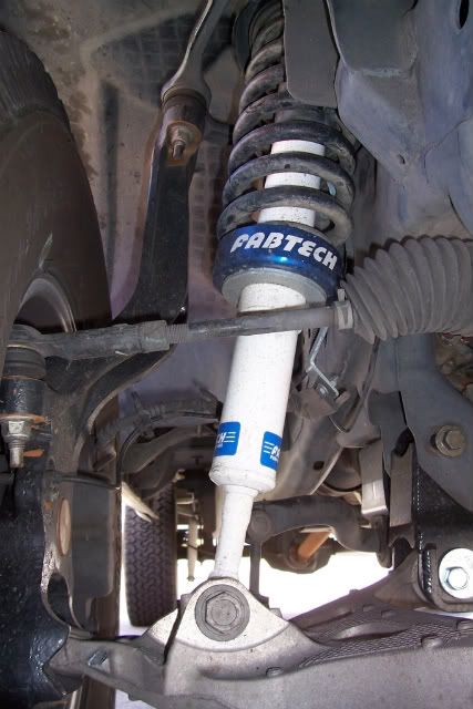

Originally Posted by chazf150
I had a 2.5 on mine when it was stock . It wasn`t like that . Is it intsalled correct ? I have a 2" on top of my 6" and it looks like this .
This is how mine looks...everything looks so bent compared to yours..maybe because you have a lift? Sorry about the pic quality too..took it at night
Old Oct 12, 2010 | 08:48 PM
2009KR's Avatar
Joined: May 2010
Posts: 371
Just to second some of the other comments, If you really have the weight on the truck in the first photo, something is ridiculously wrong. That truck can't really be drivable. Are you SURE the upper control arm is resting on the springs with weight on the vehicle? This means when you lower the truck after jacking it up, it stops lowering as soon as the tire hits the ground (neglecting the tire squish) since there is ZERO suspension travel - hard to imagine!
Old Oct 13, 2010 | 12:02 AM
kazbek1's Avatar
Joined: Aug 2010
Posts: 93
From: Jersey
Yea, those pics are of the truck resting on the ground..I literally just went outside, stuck my camera in the wheel well, and snapped some pictures...the picture shown above is also the truck just standing. I've been driving it but I just have to deal with a really rough ride...It certainly doesn't look right which is why I'm beggin for help here
Old Oct 13, 2010 | 07:22 AM
lakemarykid's Avatar
Joined: May 2006
Posts: 438
From: Lake Mary, FL
Not to come off as a jerk, but you have to help yourself some too. We have asked for pictures of the strut/strut tower to try and distinguish what sort of leveling kit you have and how it is positioned. Without that we're taking shots in the dark. It is almost like you maybe have 2 leveling kits or a leveling kits stacked or a leveling kit and shocks that are adjusted for lift.
-Curtis-
Nah its cool...Which part of the strut/strut tower do you need to see? Like how do you want me to take pics of it? I thought the pics I previously posted showed that for the most part. You want me to take pics of the top of the strut without taking everything off first? Hate to sound like a noob but I guess I just dont know what part youre talking about
Ok, here's what we need to see...below are two examples but as long as you get a picture of the TOP of the strut tower:
or
Old Oct 13, 2010 | 06:25 PM
kazbek1's Avatar
Joined: Aug 2010
Posts: 93
From: Jersey
Duh, I knew that...im lazy and thought i already posted those pics and didnt double check...my bad:
The guys at OK said that I have a 3" leveling kit which is making it sag...i have a 2" that i got in the mail the other day which should fix the problem...still need to replace my driver side UCA which I should be doing tomorrow so Ill let you guys know how it turns out...any other ideas guys besides the one that OK gave me?
