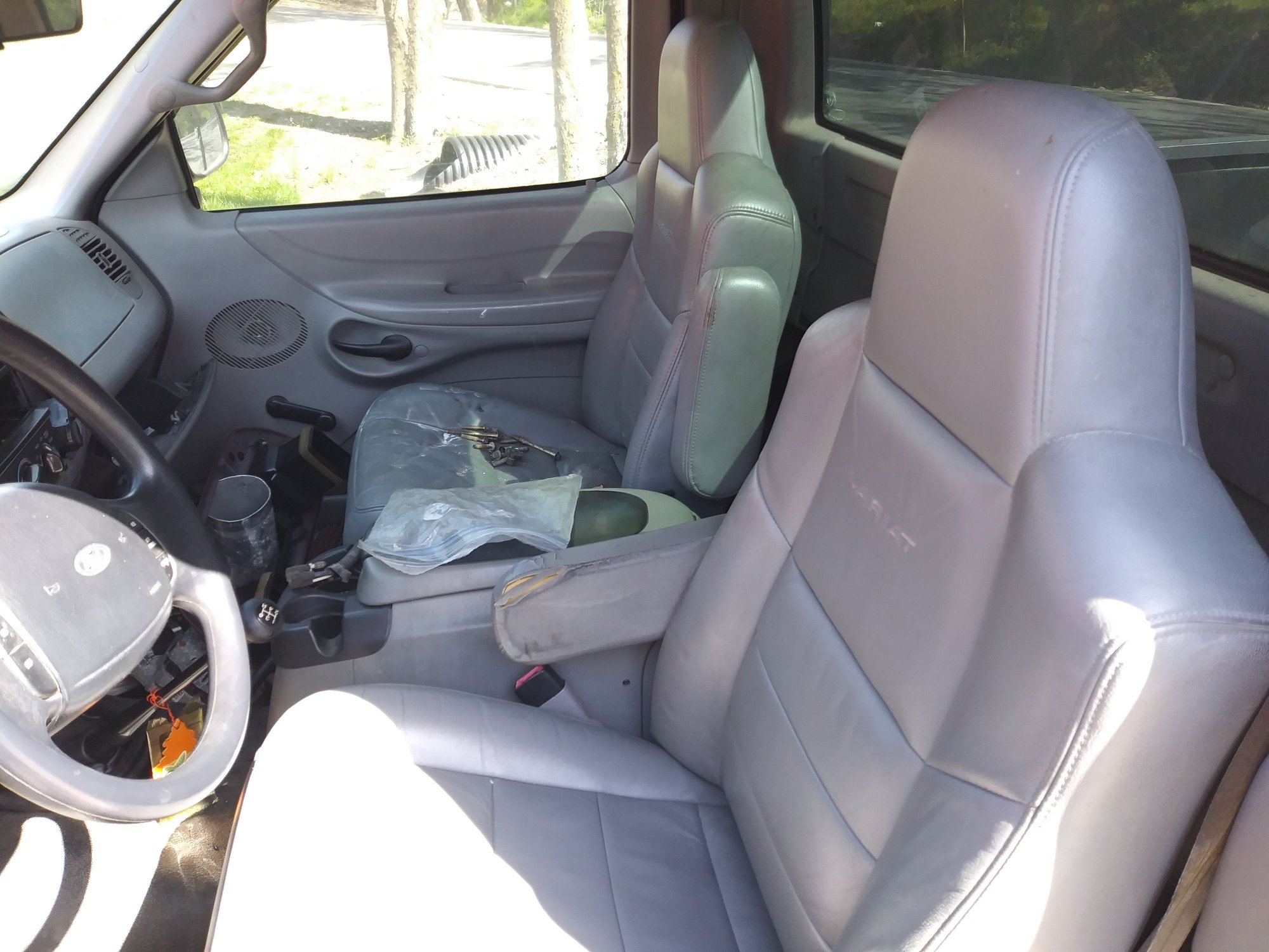

Figured i might post a couple of pics
Old Apr 5, 2018 | 07:36 AM
Already looks like an interesting project.
