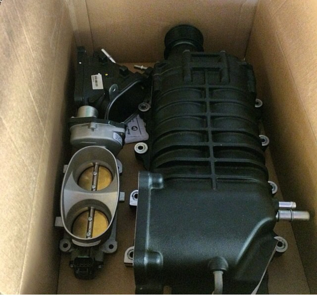

So I have a friend who has a super charge from a GT500 with only ~5000 miles on it. He was planning on installing it in a 03' SCrew but is now selling it for $600. It needs a few things which he is going to give me a list.. but for $600 are these parts worth it?
I believe it needs intercooler?, intake from a lighting/harley? injectors, belt, etc.
Will this fit on my 06' screw? Is this hassle worth it parting it together, the price seems great.
Thanks in advance!

will it work:
yes, after a lot of time and money making one off peices for your three valve
while there are "adapter" plates for use on a Lightning /factory supercharged Harley truck there is not currently anything available for the three valve 5.4 motors (just talks about it)
so unfortuantly, you cannot use this on your truck without incurring some extensive expenses

unfortuantly, honesty is the best option and i'd hate to see you misled or worse make a purchase and then find out later you can't use it
and these blowers are selling for $350-$400
