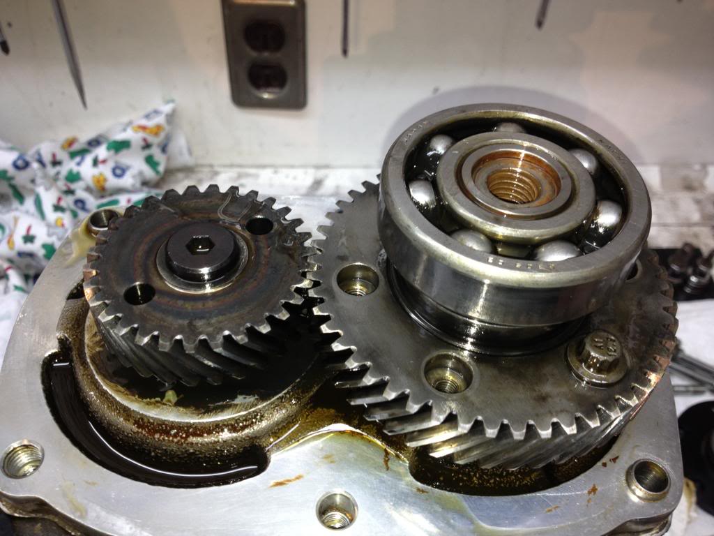

The shaft the the pulley bolts too? The bolt holds the shaft to the lobe hub. If the bolt broken then I have a shaft / bolt for ya.
Her you can see where the shaft bolts to the 5 lube timing hub. Well technically you cannot lol, but once the bearing is pulled you will see 3 lobes and 3 cap heads.

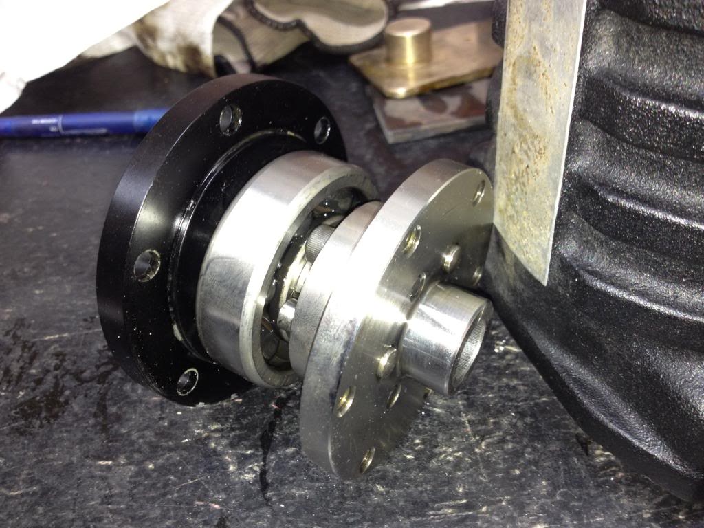

I you pull the blower, remove the top cover, the Direct drive assembly simply bolts to the timing hub. It would be real easy to swap out.
This pic.
The drive bolts to the hub via those Cap screws below the bearing. The bearing will slide off with a decent 3 leg puller.
