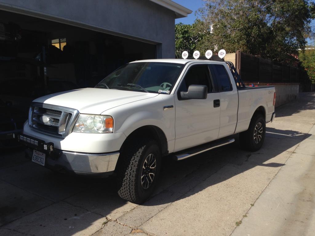

Yes I finally did. Took quite a bit of time and a ridiculous amount of money but we finally got there... The last dyno tune put out 338 hp and 401 tq to the wheels. That is a conservative tune (need to run on Mexico premium) on 35's with the 3.73 rear end. It runs really nice and the cams make it sound amazing... I think the new rear end will really set it off nice and make it go like a bat out of hell (for a big truck at least).
Here's a pic...
Old Jun 2, 2014 | 04:04 PM
Looks good! I know how much time and money (and frustrstion) it's taken to get to this point. One hell of a "free" truck, ain't it?
