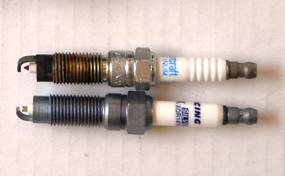

You may not have any issues at all with spark plugs. Since your truck is a 2008, you might have the revised heads with conventional spark plugs. Ford started putting the new heads in trucks sometime around October 2007. If your COP boots are brown, you have the newer style heads and the revised spark plugs. Make sure which plugs you have before you order. Brisk does make a colder plug for the new heads, but they are the only source I have been able to find. If you need help locating the plug number, let me know.
Here's what the newer plugs look like next to the stock plug. Most of the part number is visible in the picture.
