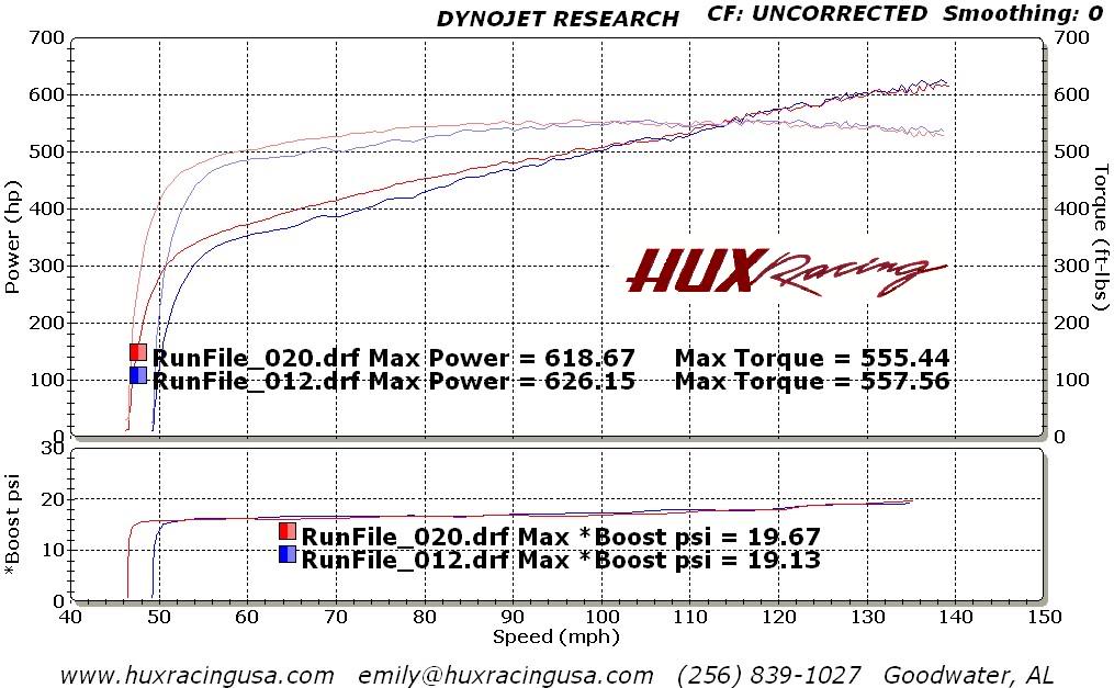

Yep, got it tuned today. I'll post up some dyno sheets later.

Here's the uncorrected dyno sheet. I'll get an SAE corrected one later and some dyno and driving video posted up when I get it. This is with 18* timing. I was hoping for a little more, but this is to be expected with a big ***, heavy truck, automatic tranny, and 20" wheels.
