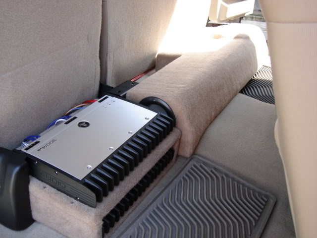

I want to build the box so that it fits similar to my existing box.
Here is what my existing box looks like now...
Because the box will be bigger, I'm probably going to wind up mounting the amps behind the seat.
So, with those box specs above, do you guys think that a box made with 3/4" MDF is doable?
I realize that the box will have to be a little wider and that may make it to where I won't be able to raise my back seat.
Also, with those specs, can't I calculate that and have a round port similar to my existing box, instead of a rectangular port, or should I just go with a plain Jane slotted port?

Unlikely they made it "perfectly to spec" since working with volume within fiberglass enclosure isn't an exact science.
Why do you want a 12"?
Have you considered a solution from supercrewsound.com? They sell dual 10's and dual 12's that will fit under the seat... and one of the options includes a seat lift to ensure it will fit.
