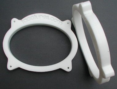

Don't double up the entire side of the box, just where the speaker mounts. Much like the attached pic, but round of course. Glue it together and you're good to go.

That won't help, it looks like the area the weight is distributed would not change with those rings (if they even make them in the correct size), it might even be worse.

I'm not saying use those exact rings. I'm saying to make something similar out of 3/4" MDF to use as a mounting plate and glue it to the box. It most certainly will not be worse than only having a 3/4" plate. I've seen this procedure done countless times on boxes with 15" subs.
