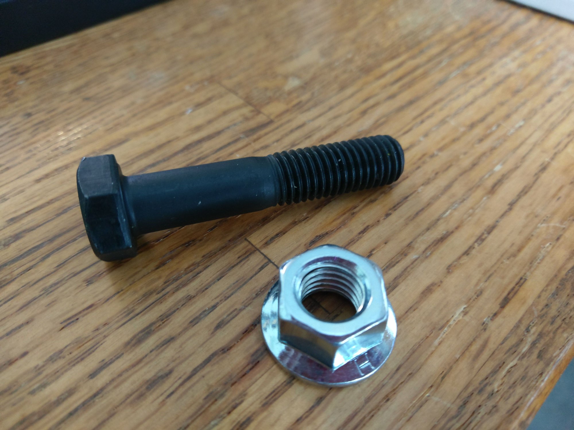

Hi Guys,
I have a 4x4 non-quad shock set up. I am replacing all four shocks. The bolts are all rusted to the point where oil/ torch impact-wrench do nothing. I will have to cut them all off.
Does anyone know what mounting bolts I need for the four lower bolts? (before I disable my one vehicle, LOL)
Thanks for any info,
Ernst

For posterity, what worked for me:
Grade 10.9
12mm diameter (tried 7/16th" but too loose)
60mm length
~ 30mm shank 30mm thread
Replacement lower shock mount bolts for a 93 F150 12mmx 60mm
