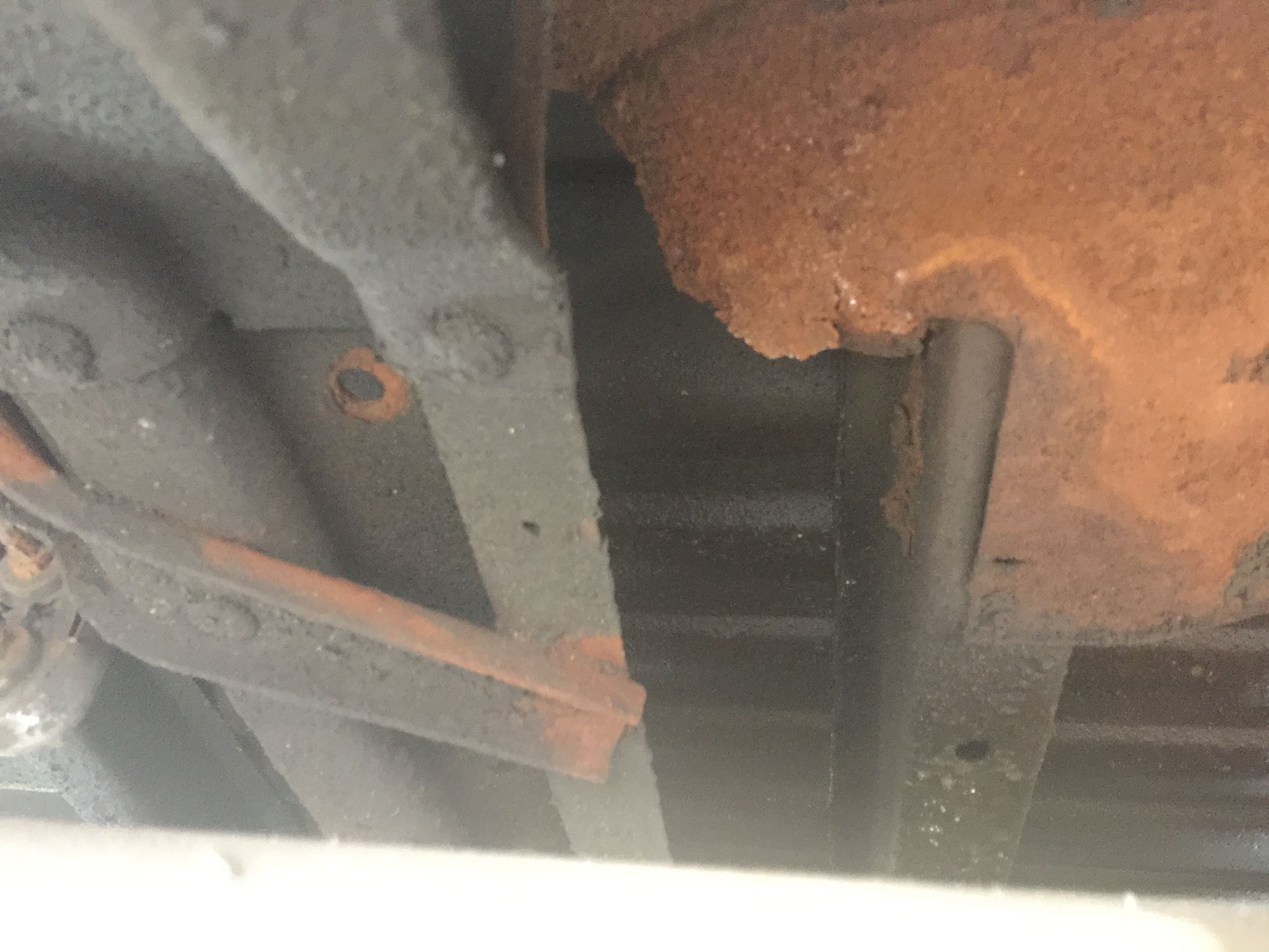

Hi, yes in new, take it easy on me lol. I've been driving my fathers '94 f250 diesel and something fell off last night as I was coming home. If you tell me what is missing in the picture I will post my question in the appropriate thread. 😀

She's rusty and oily and dirty as hell under there. I have medical knowledge, not mechanical but I know more than it sounds like lol. Is the rear fuel tank mounted beside the front or WAS it? The rear tank wasn't used because it leaked anyway ��

Looks like you lost part of your heat shield. Not a big deal, most of these trucks lost them years ago.
The rear gas tank is at the very back in the middle - above the spare tire.
Looks like you're also missing an exhaust hanger bushing - that's the rubber thing with holes on either end that fits over the spikey looking thing; you can see you have one on one side but not the other. Also not a real big deal but maybe get it checked so your exhaust pipe doesn't break.

Check; and without it the exhaust pipe might rattle like hell! So you really should replace it.

If you can even hear it rattle over the rattle of the diesel!
