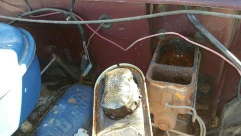

Master cylinder after sitting for 15 years. Gnarly!

The '87-96 Aluminum MC is a nearly-direct swap for that old cast Iron POS. The corresponding thinner (lighter) booster IS a direct swap on '80-86 trucks. IDK if the firewall pattern is the same on yours.
Will the 87-96 MC still bolt up, even if mine doesn't have a booster?(all manual).

I fully expect it to, but I'm not familiar with trucks older than '80, except '66-77 Broncos. Your current pushrod (attached to the pedal) should fit into the later MC just like it does the cast Iron one, and I know the mounting bolt holes are the same (because they fit onto the booster the same). But you can probably add a '73 booster - maybe even an '87-96.
