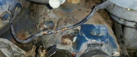

This wire that goes from the distributor to the coil was chewed up by rats. Does anybody know if I can get a replacement wire, or will I have to try to fix it?

The coolant looks like someone has overloaded it with stop-leak products. I suspect you'll find serious problems with that block, heads, &/or head gaskets.
The distributor pic is too small to make out, but in general: wires can be repaired, replaced, or upgraded. If you really want to drive & enjoy the truck, I highly recommend an upgrade. My first choice is always MODERN EFI.

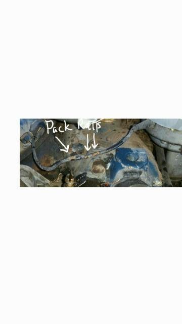

Stop leak was my first thought also, but after closer inspection, after I pulled out the thermostat, someone had siliconed the hell out of it, inside the housing around the thermostats edges(My guess to keep it in place while installing). When I drained the radiator, and pulled the hoses off, the coolant that came out looked surprisingly fresh(nice green color and not congealed at all). If flowed out of the block and radiator like if it had been put in last month, not 15 years ago. I'm hoping the coolant that surrounded the thermostat, over time, had a chemical reaction with the silicone in that area which caused it to jelly up like that.
Here's a better pic of that wire. So far I've counted 4 wires that have been gnawed at. I'm still cleaning up leaves, twigs, grass, cactus from crevices around the engine bay.
I am an electrician by trade, and I have worked on a lot homes that have had fire damage due to pack rats chewing on wire insulation, which in turn causes short circuit fires. They are some gnarly little critters. They might be known for packing, but they have many other talents they're famous for also.

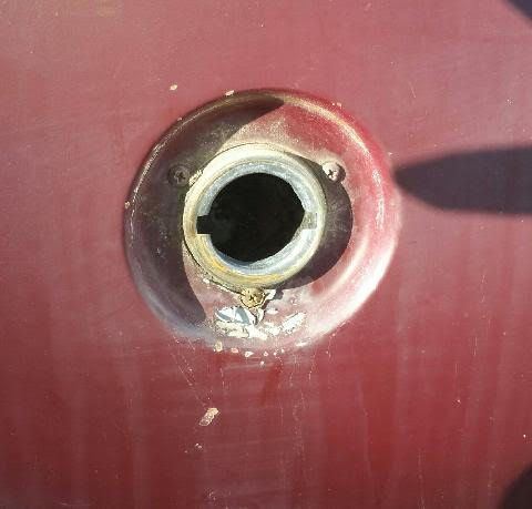

I got the large filler neck hole on my truck.

You should on a 73. Unleaded wasn't mandated on a F100 till 75, that was the first year of the catalytic converter. A 73 did not "need" leaded gas, all domestic light duty engines had hardened valve seats and low compression to allow low octane unleaded (91 RON, 87 pump octane) starting in 1971.

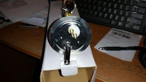

One more dilemma, So I ordered a new sending unit from Rock Auto. The original sending unit has two lines on it, send and I think return. The new sender only has one line. I've been looking all over online, and all the aftermarket/replacement senders only have one line. Is there something I'm missing. And if this is the correct part, where do I hook up the return to?
