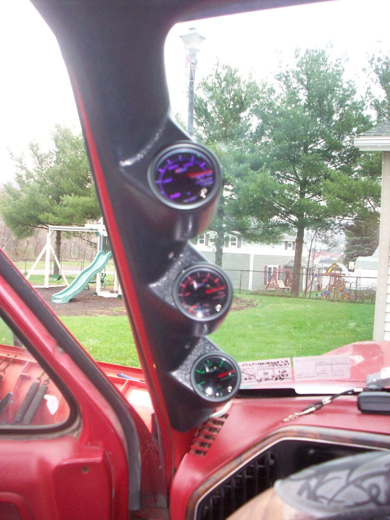

I just cut the bottom of it off where the 92-97 trucks would form onto the dash and made my own holes to pull the pod up tight onto the stock pillar.
Like so..
I didn't use the very bottom hole it shows. I notched that out so the wires had a spot to run and were down out of site, I will get a picture of that tomorrow.
In stead I put two screws in between the gauges.
