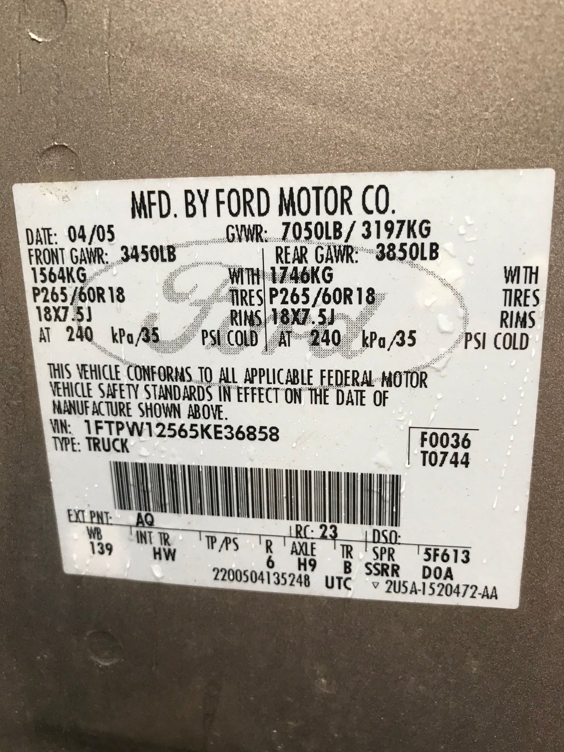

If your truck has a traction lock rear, the clutches could be worn out. Look at the sticker on the door jam and tell us what the rear end code is. If the clutches are worn out, they can be replaced. Not such a big deal.
Old Feb 11, 2021 | 10:34 AM
Paulb1212's Avatar
Joined: Feb 2021
Posts: 6
Old Feb 11, 2021 | 03:19 PM
Posts: 43,526
Yes, that's limited slip.
Change the differential lube. You need 75W140 full synthetic gear oil (any brand), and a bottle of Motorcraft XL3 friction modifier.
