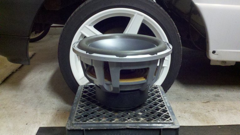

Here are some pictures of the RE Audio SRX10s
Look at the size of this magnet!

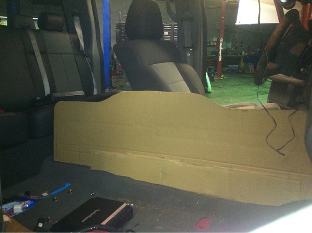

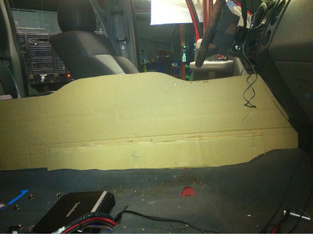

Here you guys go, a rough shape of what the console is going to look like. It's going to be closer to the .65 ft^3 but think about it 4 10s in a ported center console, this thing is going to hit so hard it might knock teeth out!

all four subs combined need that .65ft^3? Thats seems a little too small imo. Its gonna look good when its done tho.
Not to derail, i've been lookin at some SA-8 V.2's. And them little pigs need .5-.75ft^3 ported. Fittin two of those in a reg cab is near impossible lol.
Old Aug 15, 2012 | 11:18 PM
ibf150's Avatar
Joined: Jul 2011
Posts: 204
From: Metairie, LA
No it will be .65 per woofer total volume I'm looking at a little under 3.5 ft^3 but thats without accounting for port/woofer displacement after that I should be at just a hair over .65 per sub. It will be getting polyfill as well though.

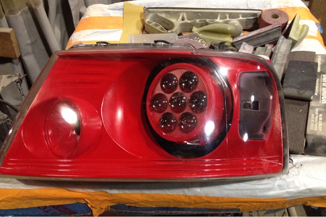

I have the first side and the bottom of the console cut, cupholder area is here. I need to buy my big 3 upgrade wires, and the material to cover the console. To be honest I've been distracted with my projector retrofit:
But I blew one of the Rockford subs so as soon as the headlights are completely finished it will be pedal to the metal on this center console build. I miss having bass, I also need to order 8 sets of components. That will consist of all 4 doors, a pair in kick-panels up front and a pair in the headliner by the back window in fiberglass pods. The headliner will be covered in suede after the components are installed.
