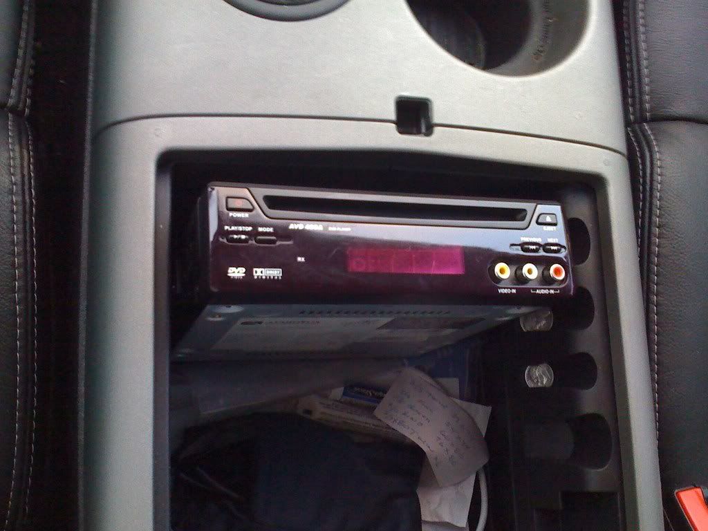

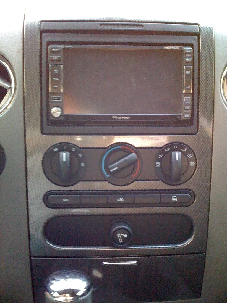

I finally got around to installing the D2, reverse camera, ipod, and Sirius that I inherited out of the wifes old CRV. The original owner of my truck had some type of Pioneer unit that had been stolen.
He left behind the reverse camera, dvd player, gps antenna when he traded off the truck. When I pulled the panel around the shifter I found an extra present, Pioneer Ipod adapter. I had to chase wires that had been cut. The reverse camera and gps antenna had been cut, so they got pulled out and replaced with mine. I had it mostly finished last night but did not have any screws to secure the dash kit to the radio.
I got it finished tonight. The only 2 things I need to fix are the gps antenna location, and ir for the dvd player. I attached the GPS antenna on the metal frame behind the radio. It gets signal, but is about 3 bars from being full strength. The original antenna was located on the drivers side of the dash by the pillar. There is a harness out of the DVD player that I think is a IR lead for the IR remote.
Overall I am very very impressed and pleased. As everybody has said the sound quality is much improved. The video quality is good. I also scored a copy of the Matrix in the DVD player when I powered it up.
