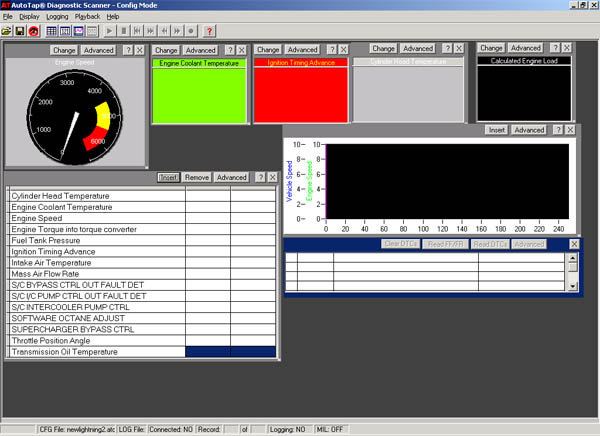

Depending on the version of Autotap software you have it may show 2 intake air temp readings. One like you mentioned gets near ambient very quickly and easily even with Sals 2 year old open filter the other stays about 20 degrees hgher.
I havent figured out where the respetive sensors are but they are clearly different.
PS - Autotap JUST released new software and a hardware upgrade is avail as well.. The new software is a big improvement...
here is screenshot of new interface

Doug, if it helps, Ford labels IAT1 and the ambient sensor, and IAT2 as the one after the intercooler. If you can log both, then the IAT1 should drop as you make a blast, while IAT2 should rise as the blower produces extra heat under boost.

Thanks for the tip Sal
If you look at the screenshot the table has some sample paramaters I used from the one avail in new software. The intake air temp is just listed as Intake air temp. And what is weird is that some times the parameters load and you get 2 listings for IAT and some times you don't but as I recall they were both labeled the same by autotap..

Doug, does the Autotap actually show Tranny temps for our L's as well?

Yes if you look at the table on the screenshot the Trans oil temp is there .....
Ill get some better screenshots this weekend
