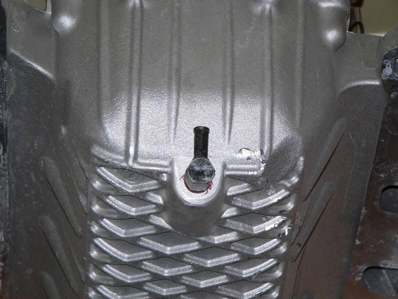

Yours may not be an oh well, there is a PCV rubber elbow that runs off the bottom of the lower intake. It can and does break down over time and could be your problem, be the way it is a pain in the a$$ to get at.
