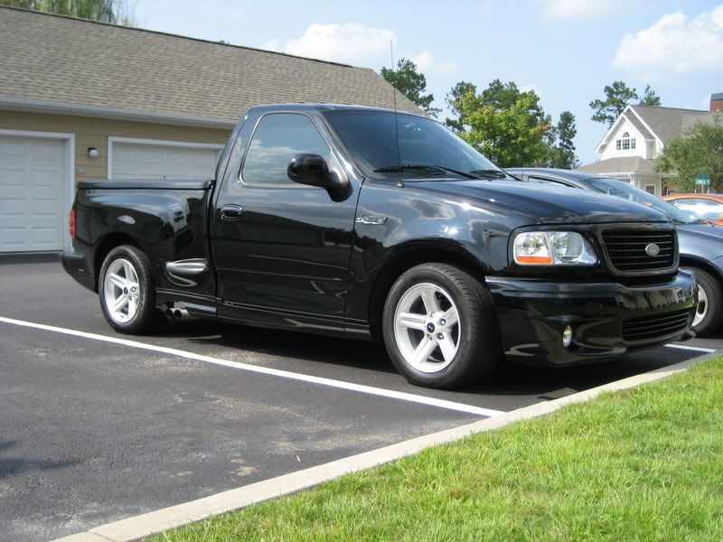

Since you plan on towing a good bit with it, I would just swap out your leafs with some 01,02 etc years and install a FRPP Drop kit. Thats just my opinion..I like the MILD drops haha.
This pics is of my 03 with the FRPP Drop kit and 1 leaf removed from the stock leafs. Just another option.

Noah, that is about the look I'm looking for. Looks stock to anyone who doesn't know Lightnings but you & I know that it is lowered just a little. Perfect for what I do with the truck.
Now I have to get it out of the body shop before I can think about the FRPP kit
