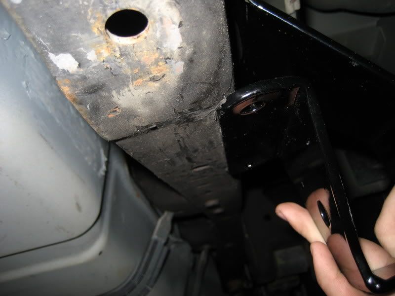

To anyone that has installed the long bars on their trucks...did ya'll have to modify/bend the front brackets to fit. You can see by the pictures that my brackets come nowhere near being able to bolt up to the frame. The only option I have is to bend them.
Has anyone else had this problem before?? Or am I missing something.

Did you utilize one of the factory holes in the frame when mounting the front brackets?? I see no way I can push the bottom of the JDM front bracket far enough to drill the bottom holes into the frame...
YES YES YES you MUST use that one factory drilled hole so it sits in the right spot
Put the FRONT brackets on first by lining up that one hole and installing that one bolt tightly.
Then put the rear Bracket on Loose and get the bar in place
Then after both sides are sitting in place, drill the other front bracket holes
and tighten then up
Then tighten the rears and BAM your done...
noah if I remember correctly when I originally lined mine up they were also off by a mile and I was like NO ****** WAY these are lining up with the hole.
I kinda forget exactly what I did to get them on but basically you have to

I believe I used this real long round steel chistle like thing I have, and put it through the bracket, and then from an angle I fished it to the hole, and then muscled the bracket until the hole lined up
