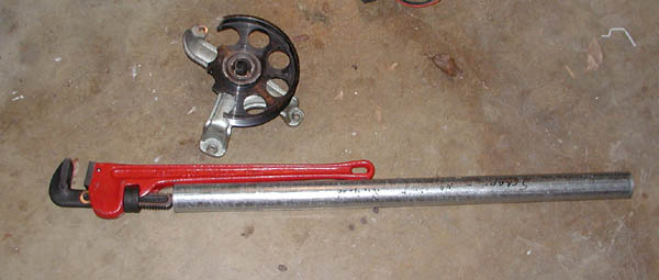

this is the peice that I have to get off still..........my JLP pulley has a center section plenty big enough, to slip over that and still bolt on flush with the other 3bolts....can anyone tell me why I shouldnt do this ?? will it hurt the truck in any way ??? I'm gettin tired of fighting with this thing...

Did the spindle snap or strip?
PB blaster over night, then again in the morning, then again before you get a big pipe wrench on it.

no Captain it spun right off with the pipe wrench and a pipe for leverage....just like SVTKY's.....
Mine looks almost exactly like this only the end isnt mangled in any way shape or form....

Don't you just take the three bolts that are inside the HB
off and the thing falls out? I can't remember ... except that
you are now at "the hard part". Maybe someone else that
had that version can help.
The '02 and up changed the way those attach I think.
Did you try the pipe wrench on the remaining piece yet?

get a quality pipe wrench and do the torque and hammer thing
Or put some tiurque on it and a "flame wrench" to heat it up some
If you have efans it shouldnt get in the way but I wouldnt leave it.
