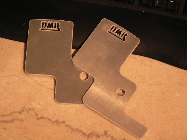

New toy,,old thread

what's that??

That is a custom bracket that holds the line lock solenoid.

I'm all for saving a few bucks when possible but when someone like Sal has done the R & D why screw arround, it's a bolt in, I can call Sal and have it in 2 days while you'll spend weeks ordering parts, the money saved just isn't worth the BS. T
