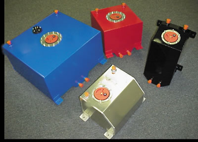

Here is a copy of a tech article I did for another website. I dont care what Icee Chiller says, our stock intercoolers are not effeicent enough to reduce intake temps to 60 degrees. Circulating water that is 45-50 degrees thru the intercooler, I saw intake temps of 95+ degrees, unless you circulate 20 degree alcohol thru the intercooler, I dont see how you could get temps down to 60 degrees. Here is the info I wrote and Datalogged:
Well Like the subject states, this is a easy and very worthwhile mod. I see guys all the time bragging about larger heat exchangers but nobody has provided proof of gains. The General rule is for every 10 degrees you can drop intake temps, expect 1% more power. If you look at my dyno graphs you will see that this is true. If you have a flip chip or way to tune your truck expect even bigger gains. What Ive done is nothing new, I simply took something that has been used on race cars for years and applied it to our trucks.My brother has a NMRA Outlaw car and after the car was built I decided to apply the same thing to my truck. This Modification took me less than 2 hours to install and the results were peak gains of 21RWHP 28RWTQ, minimiun gains of 12RWHP 14RWTQ and a average gain of 17RWHP 20FTTQ. Here are the dyno graphs,
Base Dyno on truck with a 30 minute cooldown coming off the street
http://home.comcast.net/~redracer145...1/site1014.jpg
Dyno Run with 16lbs of ice in cell and only a 12 minute cooldown after 1st run
Dyno run with water drained, 8lbs ice added and only a 8 minute cooldown. There was prolly the same amount of ice as 2nd pull. The difference is on the 2nd run ice chips were clogging the feed line, on 3rd run I put my hand in front off pickup so only water went thru and not be plugged by ice chips.
This is Dyno Number 1 and Dyno number 3 overlapped
While Ive listed actual gains on my truck, here are the actual drops in air charge after the intercooler. On the 1st run my intake temps peaked at 134 Degrees, 2nd run intake temps peaked at 99 degrees and on 3rd run peaked at 97 Degrees. At the time of the Dyno the temps were 78 Degrees, 33% Humidity, 28.77 Baro and a SAE Correction factor of 1.03. The inlet temps on these 3 runs was 81 degrees, All intake temps were taken with Ford Scan Tool from IAT1 & IAT2. The timing on my reflashed Computer showed a max Timing of 17 Degrees and a/f ratio of 13:1 at 3600 dipping to 12:1 from 4300 up to redline. Being that my intake temps had dropped, if I had a way to tune I could have added a several degrees of timing, leaned it out a bit and results would have been better. The Modifications my 2002 Lightning has are 6lb Lower Pulley, Electric Fan, 01 GT Water Pump, Borla Catback, 12 Inch K&N Conical filter and the above mentioned Cooler. At the race track Ive run 12.8@107 on stock tires with a 1.95 60ft. I think Ive given you guys all the technical data I can, now I will show you pictures and give you a list of parts needed for this little project.
1- Fuel Cell- I chose a Nice Aluminium Fuel Cell from www.summitracing.com it cost me $100 shipped to my door. Either the Black cell or the Non Painted will work, I chose the Aluminium because I wanted to have the ability to add up to 3 bags of ice on very hot days. http://static.summitracing.com/globa...m-290200pc.jpg
2- 25 foot 5/8" Hose, Steel Braided would be best but for cost options I chose regular Black hose from Home Depot. The hose I used was the stuff you use to feed water into your washing machine. It cost about $1.25/FT
3- 1/2" drain Valve, I also got this at home depot $6
4- 6-10 5/8" Hose clamps, I found these to be more expensive at Home Depot than there were at Napa. Cost was around $3 for all the clamps I needed.
The pictures will pretty much will explain everything, you could prolly mount the cell better than I did but I didnt want to drill or cut into my bed. What I do is drain the cell only leaving about 1 inch of water in the cell. When you do this be careful not to drain lower than the highest point in the system. If you drain too much water your going to have a air bubble in the system and the pump wont work. The best thing to do would be raise the fuel cell about 6-12", I didnt do it yet because Im trying to figure a way to not have to drill new holes in my bed. I also altered the direction that the water flows thru the system, if you dont do this you might have different results. The stock intercooler system has water going directly into the intercooler after the heat exchanger, this works best on the street. Doing this mod you want the water to go from your cell directly into the intercooler, if it goes thru the heat exchanger your going to heat the water before it actually goes into the intercooler. What I do is before each run I put 16lbs of ice into the Cell, I also pull the relay on the intercooler pump because I dont want the ice water to remove heat while Im in the staging lanes and approaching the line. A few cars before Im next to run, I jump out of the truck and put the relay back in, even if your intercooler core has got hot, it will cool off by the time you do your burnout and approach to starting line. After the run I still have 50% of the ice and I can either make a 2nd run or drain water and add 1/2 the ice. I usually just head back to the staging lanes, pull the relay and make a 2nd run. So long as Im not in 95 Degree sun, the remaining ice wont melt and my 2nd run is only a little slower.
