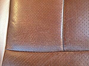

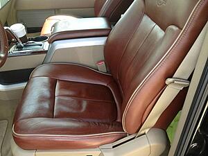

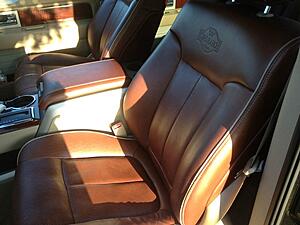

Anyone have any thoughts on how to fix the below? I use the KR Ranch conditioner about every 3 to 6 months. Keep the truck in the garage. It does sit outside at work. Live in Texas so it does get a lot of sun.
Is there a kit or treatment to fix this? I have a feeling I may need to redye the first image.

looks like its time to redye. What part of texas are you in? Have you ever tried leather cpr on the seats? I think its a better product then the kr conditioner. Good Luck

Do you slide across the seat to get in and out? It almost looks like it can be from that.

If it sits out in the sun while at work, get your windows tinted, that will help some. That sun through the glass just bakes whatever is in the truck. I agree that it looks like you slide in right where it's scuffed up.

Ours has the same markings on both seats.
Ive been wondering what to do about this. The KR conditioner makes it disappear for a while, but then it comes right back (i.e. as soon as the KR conditioner is dry).

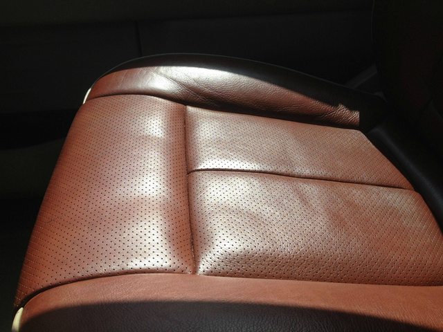

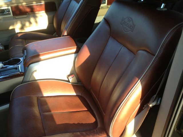

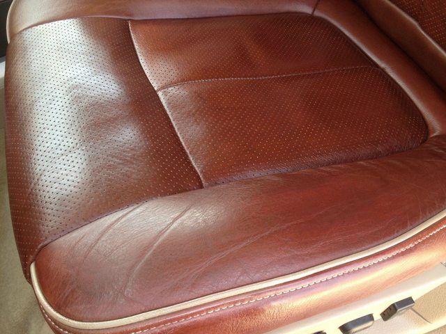

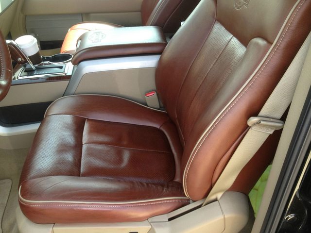

Finally got around to doing a redye job on the seats. Figure I would share how it came out. Not to bad I think for doing it myself.

Wow, that looks great. Where did you get the stuff to do the re-dye?
Old Aug 13, 2012 | 12:18 PM
acksman's Avatar
Joined: Jul 2010
Posts: 19
From: Texas
From here, premixed to the exact color. It was pretty easy other than getting past having to sandpaper your seats.

WOW! how did you keep from dying the stiching? did you use spray? How did it apply?

I used a very small foam application paint brush to apply. Very light applications. It took about 2 hours to apply 4 layers of about where I thought it should be.
As for the stitching its not perfect, but I had a microfiber towel to take care of any overage in application by blotting.
The first seat took quite a while I did the passenger seat the next weekend and it took about half the time since I knew what I was doing.
Also since the dye matches so well, you do not have to get really close to the stitching. The original matched up well. Just every once in a while I got a bit close and had to blot to not allow the stitching to soak it in.
