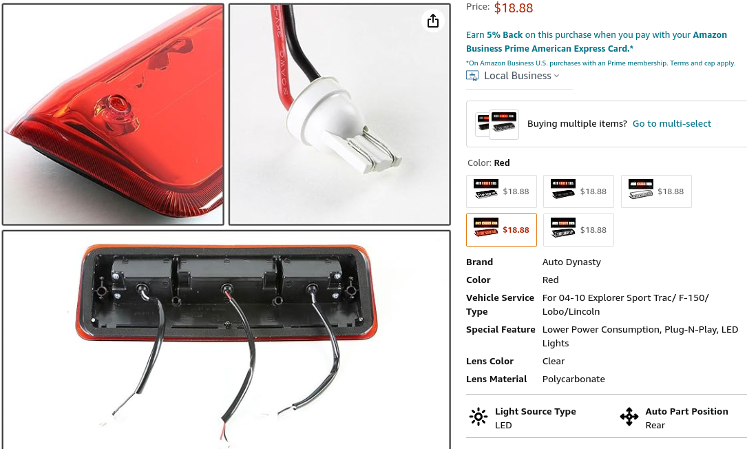

There is an issue with the OEM lamp housing. It leaked. An updated part with a bigger gasket was released. For anyone replacing lamps, it would be a good time to revise your truck. A safe bet would be to buy the Motorcraft part, and make sure that you get the new part with the thicker foam seal. Dorman makes an OEM replacement for a lower price. Double check the gasket. A lot of the "internet" parts sellers under generic names have gaskets which are thicker than OEM. Double check those if you buy them. Make sure that you can return the part if the gasket is not thick enough. I bought an aftermarket LED lamp, which was plug-and-play. The gasket was sufficient. I have not had any leaks.
