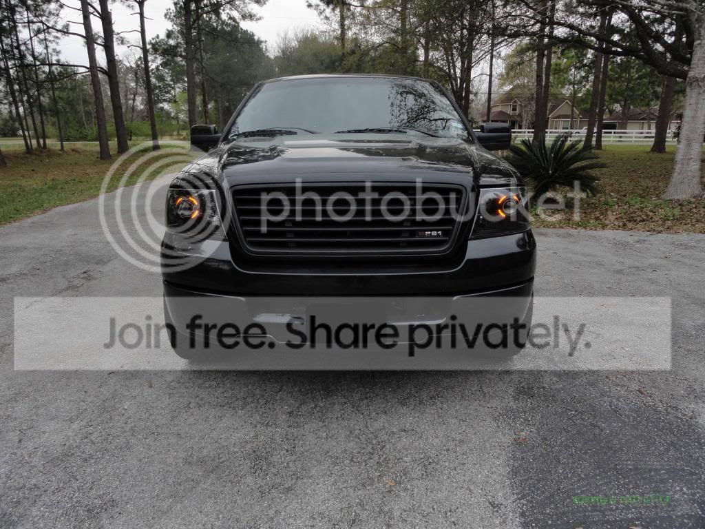

OP - in that Retrofit Members thread you may have seen a couple folks with retrofitted HID in blacked-out housings, and clear, untinted lenses. That would look real good on a black truck - and keep you both legal and safe. And provide fantastic accurate output. AND look waaaay cool Savvy?
Here's an example pitcher ( kudos to good ol' Saleen1013 ):
From this thread: https://www.f150online.com/forums/pa...e-hid-kit.html

I don't know what you don't like aboot Saleen's work. Those things look spectacular - especially on a black truck. You don;t need to use the amber halos. Without them it's totally blacked out, yet fully functional.

PS - you other jokers - fully blacked out headlites using halogens is plain silly - it must still have a chrome main reflector to work at all. That's where the projector (with a black cutoff shield), and a painted shroud come in. I think the goal here is not to see any chrome. WTF were you two thinkin'?

Originally Posted by MGDfan
Sweet Fancy Moses!!!!
That up yonder ^^ is futchin' BEEYOOTIFUL!!!
