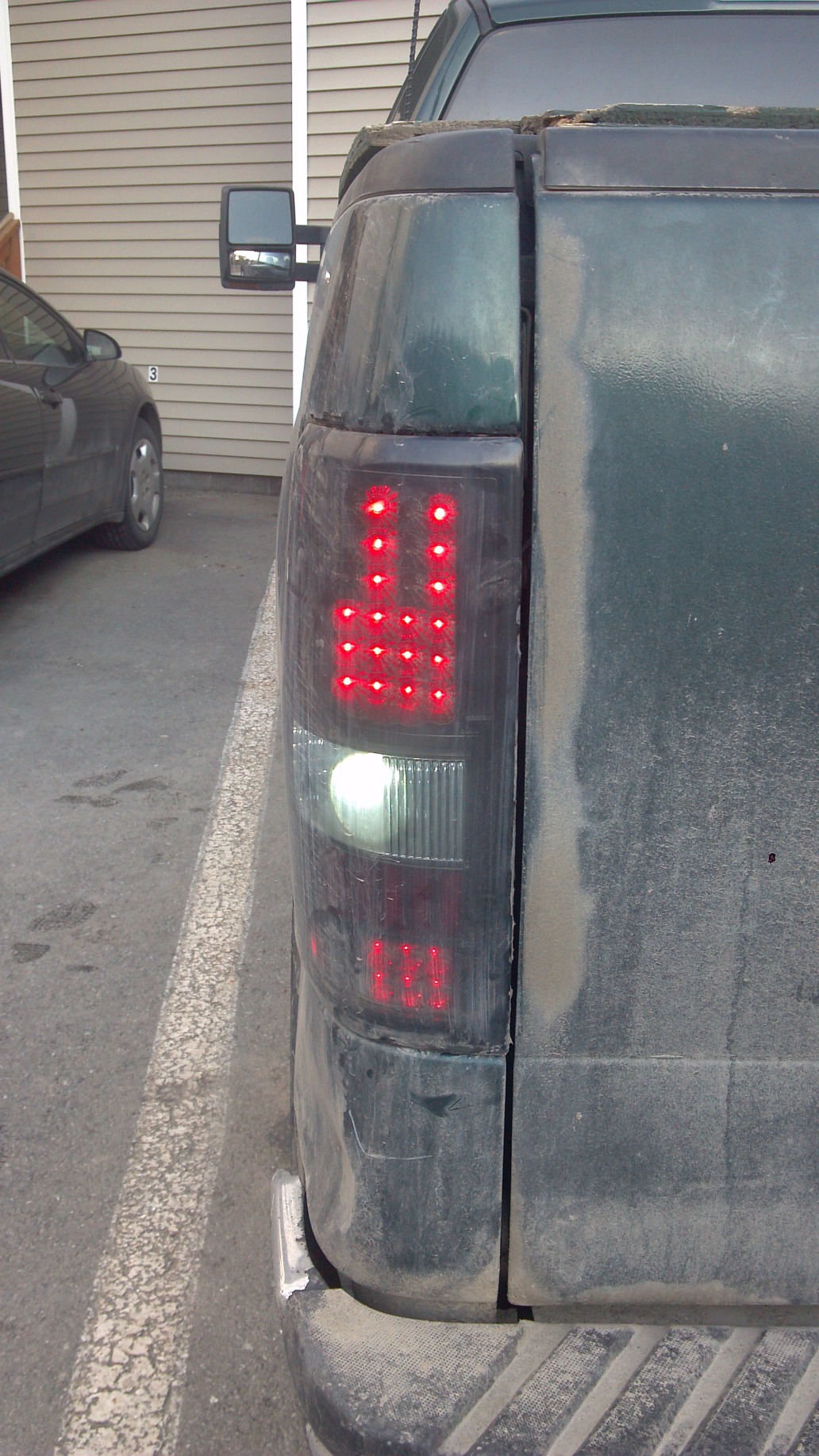

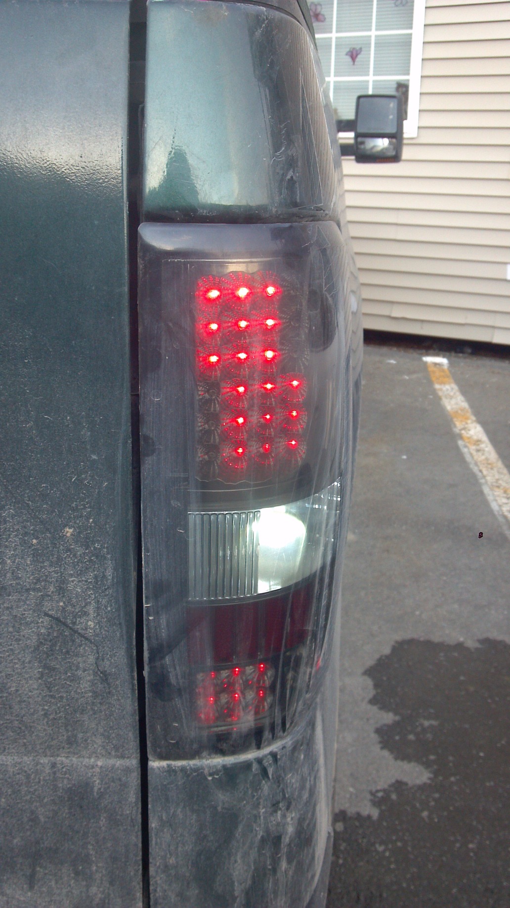

I have the same kind of lights in black. After 3 years I have 2 banks of 3leds out on each one. Only the passenger one hyperflashes. I'm gong to open them up and see whats wrong eventually.
Old May 9, 2013 | 10:28 AM
Raptor05121's Avatar
Posts: 10,610
From: Live Oak, FL
They are put in groups of three to a resistor, so obviously a cold solder joint on said resistor. Again, YGWYPF
Old May 9, 2013 | 06:08 PM
ak_cowboy's Avatar
Posts: 1,476
From: Alaska
So I should be able to open them up and just resolder those sections, right?
Old May 10, 2013 | 06:22 PM
Posts: 10,610
From: Live Oak, FL
I'm 90% sure they are covered in potting material, so no.
