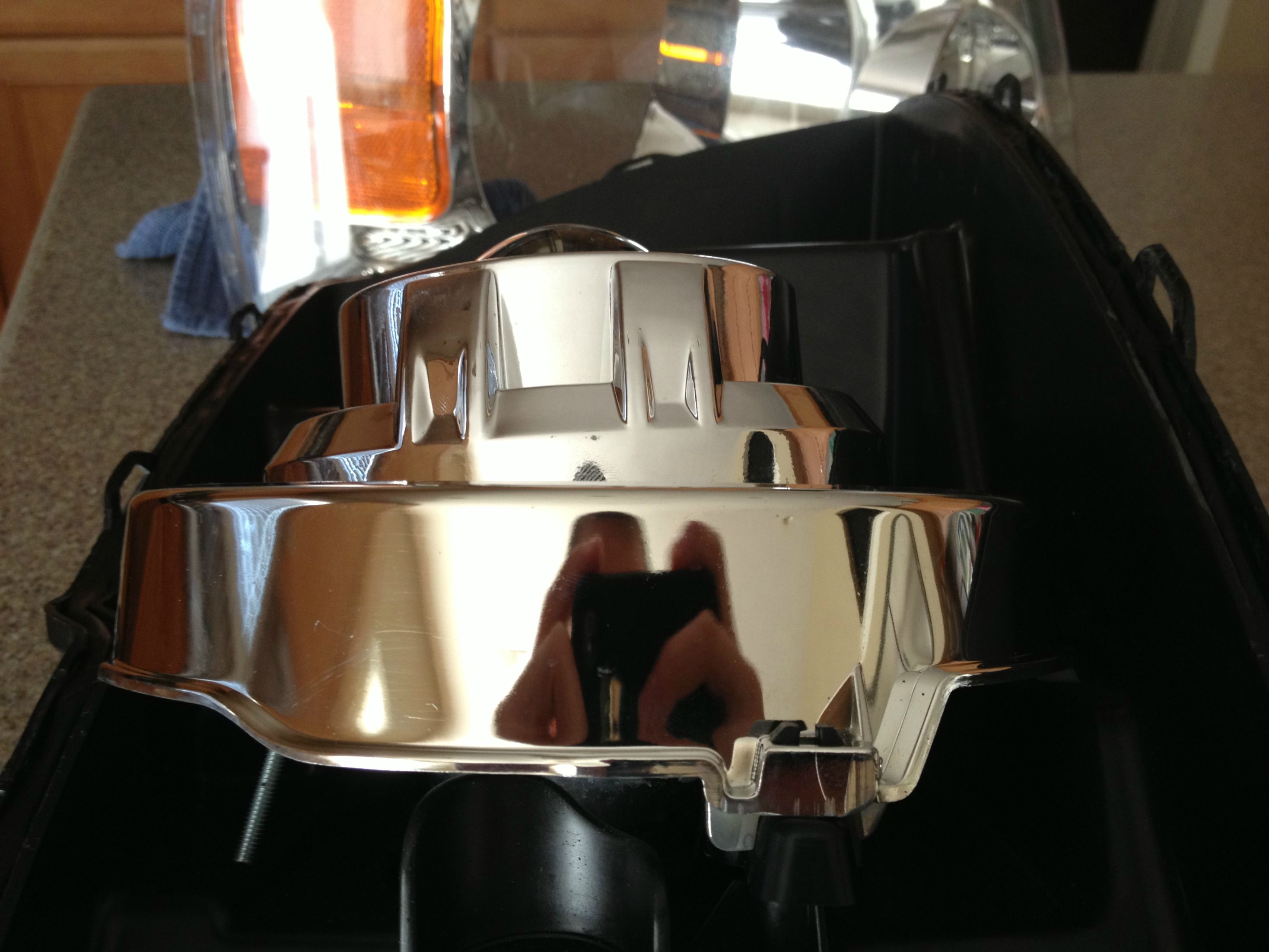

I'm doing a retrofit on my 2007 and I'm using Apollo shrouds but I can't seem to get the shroud to sit right on the projector. The top is where I want it to be but the bottom won't stay in place. I've tried silicon overnight but even that didn't work. Any suggestions? Here's what it looks like...

What projectors are you using? On my FX-Rs I had to trim the side and the bottom of my apollo shrouds to get them to fit.
Did u do any trimming? Using a centric ring?

I'm using the FX-R 2.0 with the centric rings and I did enough trimming to have it sit on the projector like I want it to but that's only if I hold it down. Once I let go it goes to the position that I have pictured
