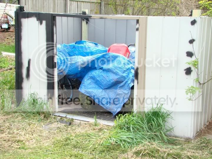

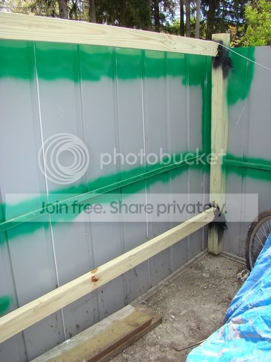

I am having to rebuild the roof of my metal garden shed which caved in last winter. I have put treated lumber posts in the corners of the shed & drilled through the outside of the shed into the lumber & put screws in. I then used simpson strong ties and put in a number of cross members (front to back & end to end). I want to put a roof on that slopes from front to back & cover it with shingles. My question is how do I know what angle to cut on the posts for the roof. The shed is 86 inches deep, its not anything that I have done before so any help would be greatly appreciated.

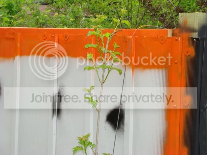

Hopefully the pics will make it clearer what I am doing. The shed is at the end of our yard so matching the pitch is not required. We get quite a bit of snow & rain but the meatal roof (which was not flat) lasted about 7 yrs.

You wont get a 3:12 out of that, 86" deep would be just over 7'.. that's a 21" slope from front to back. Judging by your pics, the front posts are not tall enough to compensate for that, so you would have to cut the back down. You can get away with a 2:12, a 14" difference... but still doesn't look like theres room for that without taller front posts or shorten the rear of the shed. If it were me, I would frame the top out and stick with the metal, doesn't need as much pitch and should last longer with less maintenance.
