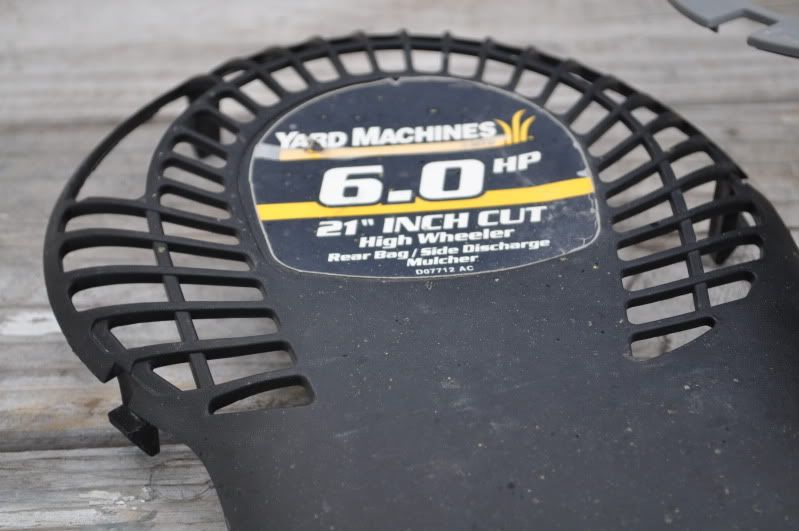

FYI, it's a B&S 6hp on a Yard Machines push mower. Here is a picture of the cover...I don't know if this info would help:

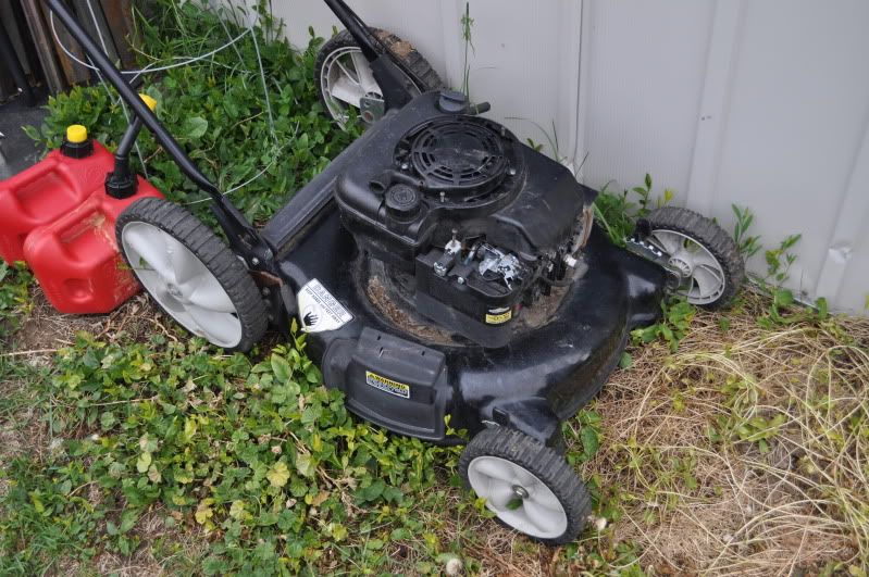

Here is the mower:

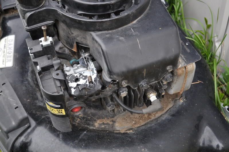

And here is a slightly closer view of the engine:
Here is the mower:
