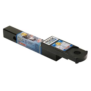

i currently have a 2 inch ball on this kind of hitch (2" drop)
and im looking to raise my tounge up a little bit but not as far as flipping that over, to make it a 2 inch rise
im looking for a class 3 hitch like this one
but i cant find one in a class 3, that one is a class 1 or 2 (the smaller box)
i know ive seen one like im looking for before, the guy i bought my ski from had one.
my wave runner sat perfect before i did my leveling kit, now it sits too low on the tounge side, and i think flipping it over will make it too high.
does anyone know if a boat is supposed to ride a little nose high or perfectly level? i kinda wanted it nose high to help it drain any water that might be in there.
ive thought about getting a tri ball too. anyone recomend that? it seems like it sticks out further than the one i have now, and it would be nice to have a 1 7/8s, 2 inch, and 2 and 5/16ths all handy.

I have a Convert A Ball. You have all the sizes you need the ball has a pin in it that you push out and can take it off the shank to put a different size on. Just get a hitch that has the drop you want and use the shank.

It should be level with the proper tongue weight, which is 8 to 15% of towed weight.

Could try something like this.
http://www.jcwhitney.com/adjustable-.../p2004318.jcwx
Old Feb 10, 2011 | 01:40 PM
Posts: 43,542
Likes: 819
If you flip a 2" drop over, you get a 3/4" rise - same as that second one you posted. I'm running a flipped 2" drop.

on my 2wd i had a flipped 4" drop its a little tall for my 4wd

Any RV/trailer/outdoor sporting goods store should have them. Also check large stores like Home Depot, Lowes, Tractor Supply, heck even Walmart. I remember seeing plenty of the 1" drops a while back.
You can also get them online
http://www.usa-trailer-hitches.com/c...all_Mounts,452
