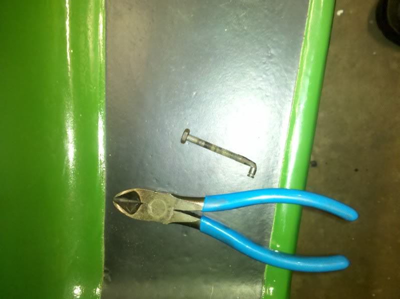

Here is the old one.

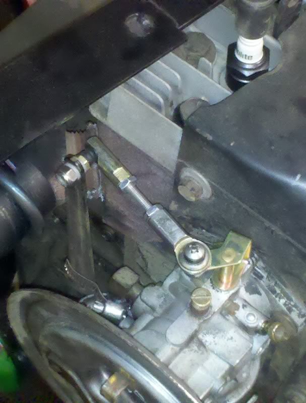

Here is the new one.
