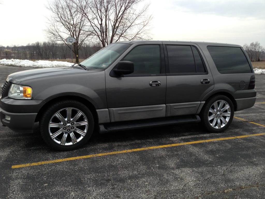

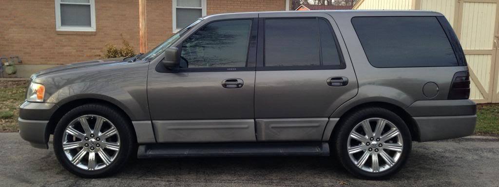

So that Friday I started on just the front since I was satisfied with the back. Everything looked right so I had decided to cut the spring to bring it down. I only cut 1/4 of a coil to start since I didn't want to take to much. I was pretty nervous already about cutting them. Here's how it turned out.

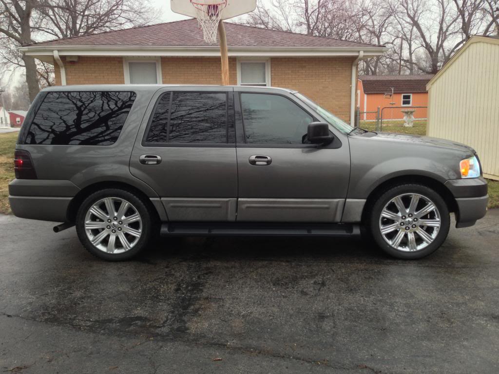

Which was definitely better but not perfect. So the following Monday I went back at the front. I took off another 1/4 of a coil and put it all back together. By this time I was getting pretty good and had both sides from start to finish done in less than an hour and a half. Now it is darn near perfect with about 1/16" difference between the front and back with the front being a hair lower. I was looking for even or a hair lower in the front so I am satisfied. So it turned out to be a pain but I'm happy with the outcome. I'm also happy that I did it myself and didn't have to worry about working with a shops schedule and trying to get them to fix it. So I am pretty confident that I could answer most questions about doing this type of drop or even the conversion since it would require the same removal and installation. So here is the final product.
So now I am wanting to go lower. I am thinking of taking another 1/4 or so of the front and the same amount for the rear. If would love another 1/2-1" lower. I may just leave it for now. I haven't decided yet.
