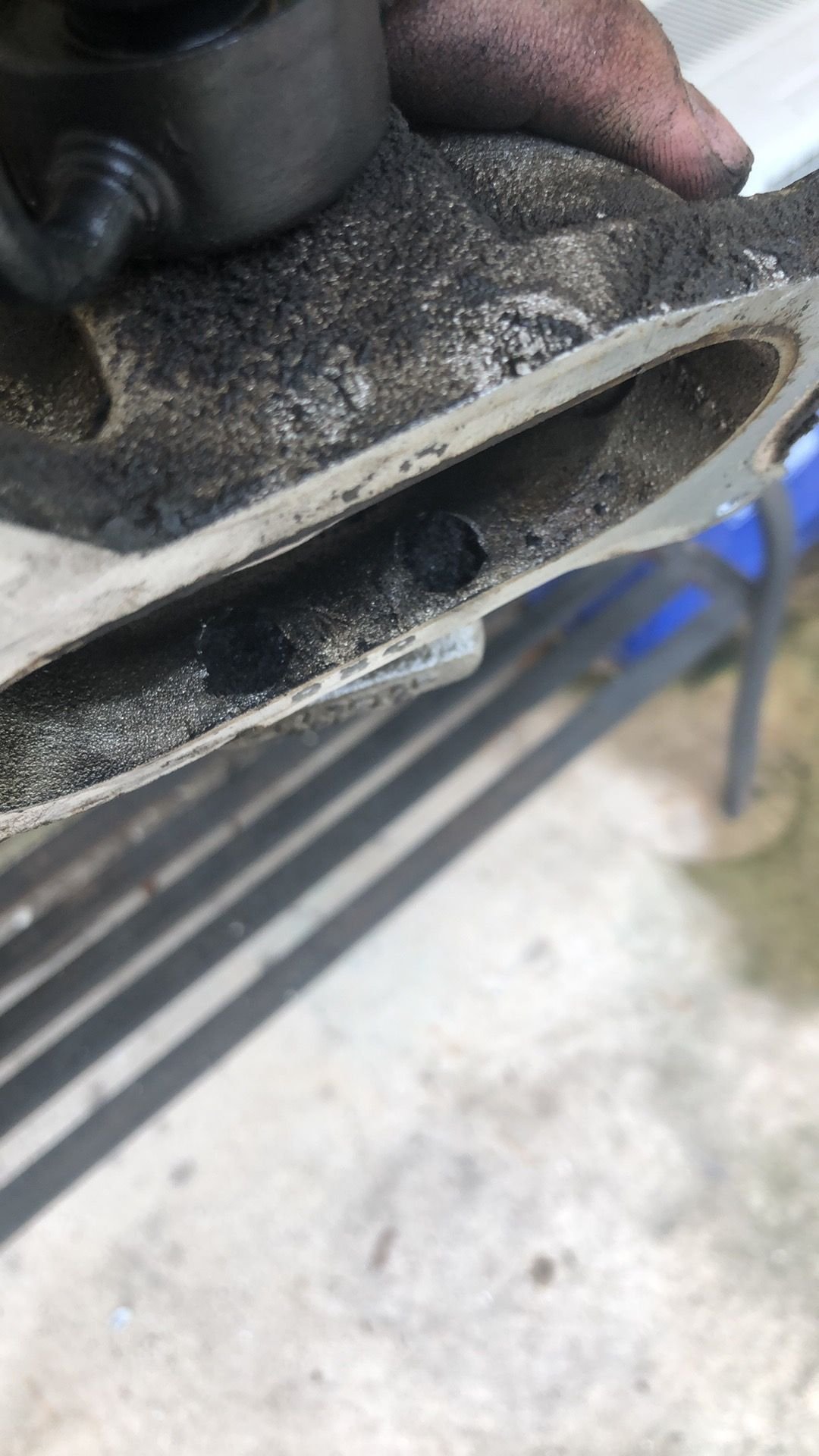

If a new EGR valve didn't fix it, either the passages in the throttle body elbow are plugged or the DPFE is bad.
Old Jul 2, 2020 | 01:48 PM
zmixon54's Avatar
Joined: Jul 2020
Posts: 5
This may of been it putting back together now
