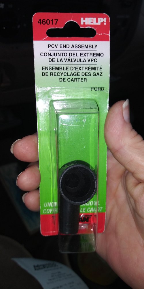

PCV Harness
I think even a blind hog finds corn every now and then. Would this be it? Tried O'Reilly's, Auto Zone and finally Advanced Auto Parts. Very knowledgeable parts counter man.

I *think* that's the one for a 5.4. Show it to your mechanic and ask if that's what it needs.
