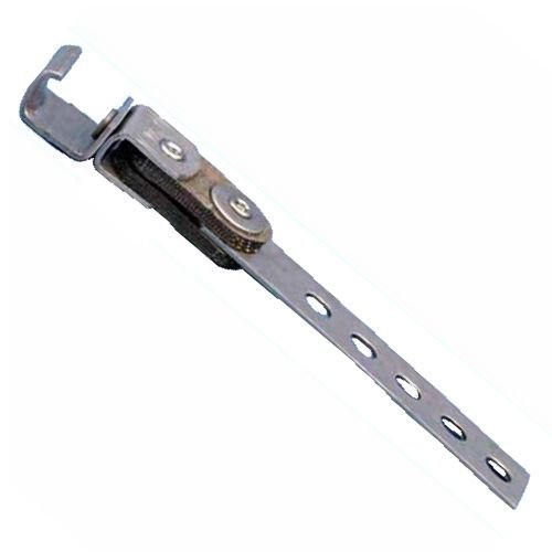

what's the current hanger bushing look like, would this work? http://static.summitracing.com/globa...PYE-HVH13S.jpg
