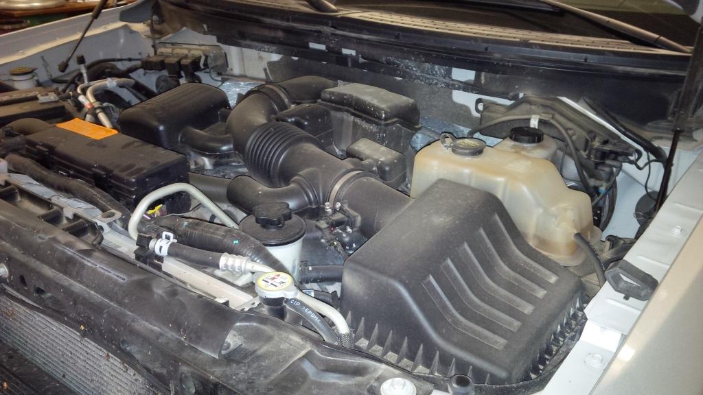

Recently picked up a new to me 2010 F-150, last truck I had was a work/company truck but thought I'd like to have one of my own again. Haven't had it long enough to do a oil change on it yet and so far have added a swing out tool box on the drivers side - passenger side ordered - and a DU-HA under seat organizer.

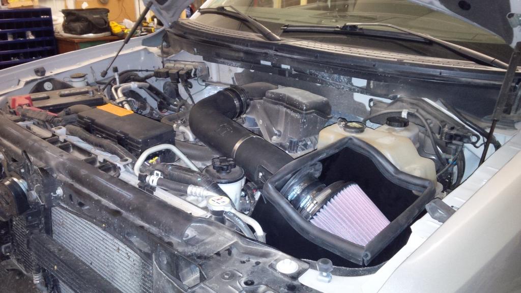

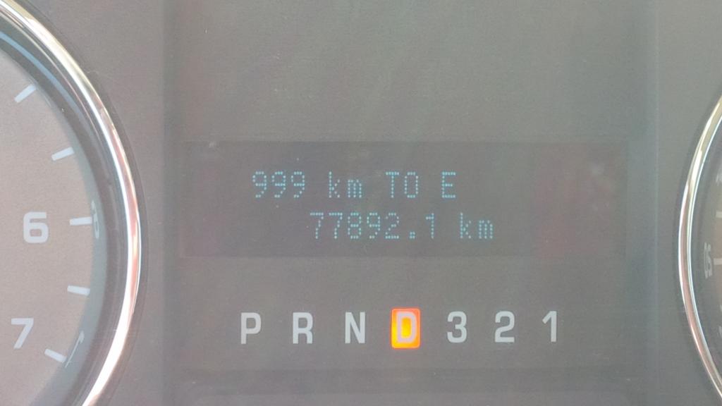

Lastly upgraded to a K&N intake system. Have only had it on since Saturday, but so far so good. Truck was showing 16L/100Km previous and is now showing 14L/100KM on the first fill after install.
Before
After
Result

You are going to need a tune to render that intake safe to use. Yer mileage results could be due to MAF TF skew.
And be prepared to keep cleaning the MAF. The K&N media is not that great at filtration - and the oil can migrate.
No power gains to speak of - the stock intake already dramatically outflows the needs of the engine.

Only been 2 days so we will see. I was always under the impression that the truck need to "learn" once a mod has been made and adapt to it. I will see how things progress over the next week or 2 and go from there.

(Apart from all of the dirt the media is missing - check the inside of the intake tude and the throttle body later - if you care)
On the 'learning' - you are mistaken - the MAF is a PRIMARY REFERENCE sensor - the MAF Transfer function (TF) is hard-coded into the PCM and is accurate ONLY for the intake the truck came with. You alter the MAF region's geometry, ( and that POS K&N certainly has) and a new TF is required. And a CEL may not occur - direct measurement required. Again - well-documented, and easily confirmed.
Let's see:
-Potential to foul the MAF
-Introduces unfiltered fine particulates into the intake tract and the oil.
-flows no better than stock
-skews the MAF transfer function
-~10% rotomolded plastic manufacturing tolerance contributing to point above
^^^ Yep a real smart mod
Yer truck - yer money (which you have just wasted) - much better to have invested in a custom tuned programmer instead - and realized real, useful, tangible gains.
That's usually the result of buying before researching. All of this vast, precious archival knowledge available - overlooked and ignored. Shame, that.
Only a Search away. If you care. Sounds like you don't.

If you want to keep the intake, replace the filter media with an amsoil or dry filter unit.
I ran an oiled drop in, and my truck did not like it. Constant cleaning of the MAF is required and IMO not worth it. I wish I could get back the $50 I spent on it as well as the cleaning solvents.
Now I have the "gotts" mod and a dry $14.00 purolator air filter from advance auto.
