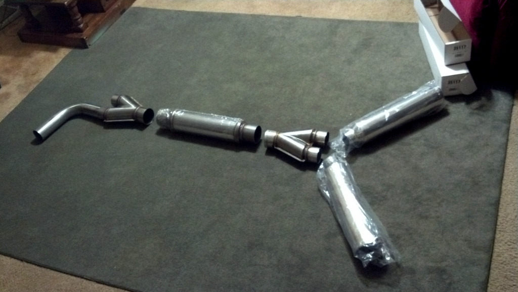

Old May 24, 2013 | 02:25 PM
Like this...

Will that setup give it the sound of true duals with no crossover, but without the downside of losing some low-end?
no
true duals gives a distinct sounds, same as each type of cross over does
that exhaust in the picture will sound like a single exhaust coming out in two places
a properly sized exhaust system will not lose any power
