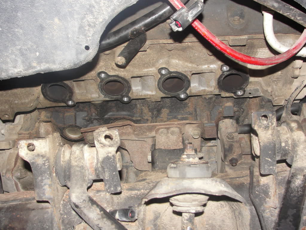

Pass. side manifolds off.

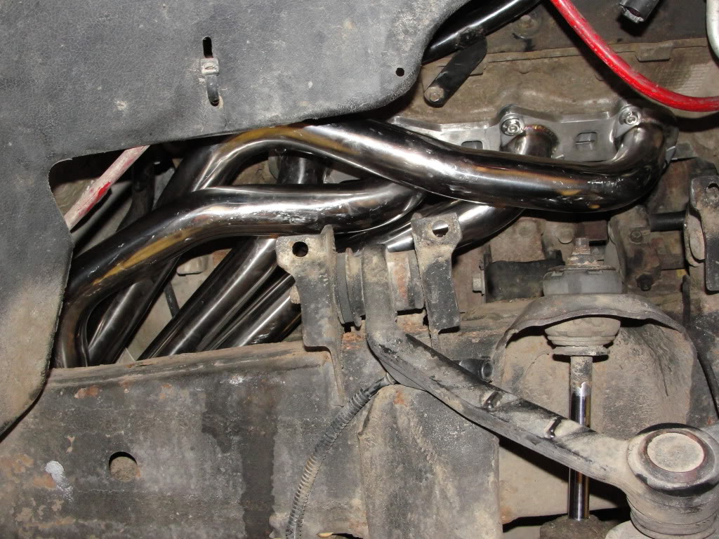

Drivers side on

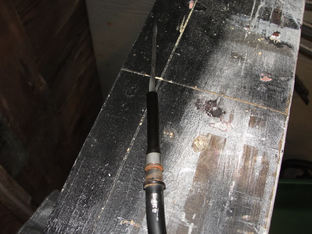

Dip stick tube

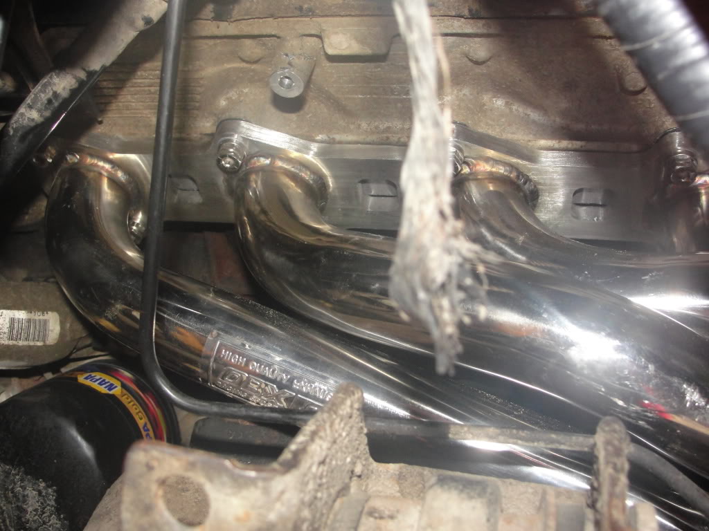

Pass. side in
