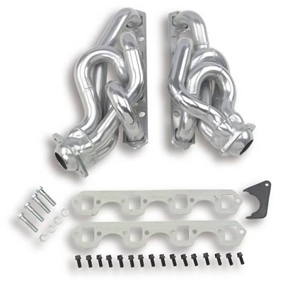

Because of the crazy bends they have in them they create more back pressure then stock manifolds. also they do not have the scavging effect like longtubes. ive had both and i deff felt a huge increase with longtubes over shortys. i dynoed with shortys at 190HP/234Ftlbs i have yet to go back with the long tubes but i know i picked up at least 20+HP and Ftlbs on the butt dyno. ill be going to the dyno once i get 400 bucks for a dyno tune and an hour on the dyno and let you guys know numbers

Shorties are exactly like OEM manifolds, same shapes, size, just a different steel grade. Longtubes are un-restricted, allow all flow, scavenging, and sound out of the engine.

just have a hard time believing this
is as restrictive as this
I'm not saying they're equivalent to longtubes.
