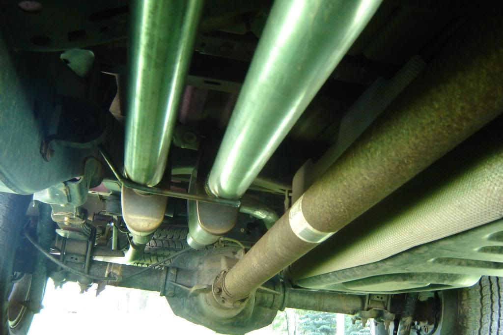

Old Jul 12, 2008 | 01:26 AM
Heres my true duals under my 2004. Same layout a 2005+ would have, only difference is I have 4 factory cats ( for now ) and not two, but my cats are hardly visible.
And my video has a better overlook of the overall exhaust.

Not at the moment, its basically two bends with the sides cut and welded together. Not the best X pipe like Magnaflows, but it works.
If you go with the si/do there will be no need for the cross over, it will perform better you just wont have that true dual sound.
