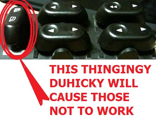

look at this if you have this switch.
http://www.f150forum.com/attachments...dow-switch.jpg
